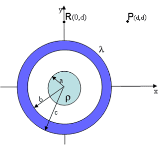

An infinitely long solid insulating cylinder of radius a = 4.3 cm is positioned with its symmetry axis along the z-axis as shown. The cylinder is uniformly charged with a charge density ρ = 28 μC/m3. Concentric with the cylinder is a cylindrical conducting shell of inner radius b = 10.1 cm, and outer radius c = 12.1 cm. The conducting shell has a linear charge density λ = -0.34μC/m.
1) What is Ey(R), the y-component of the electric field at point R, located a distance d = 48 cm from the origin along the y-axis as shown?
[/B]
ρ = Qin/V
V = 2πRL (Disregard L if I take it at 1m)
λ = Qout/L (L @ 1m) so λ = Q
Gauss - ∫E⋅dA = Qenclosed/∈0
Agauss = 2πRa < May be area of confusion
Did you already do an exercise like this but with spheres ? If you place your Gaussian surface as a cylinder around the z axis through point R, what does the theorem tell you about ##\vec E## ?
It is indeed an area of confusion. Your expression for the area is incorrect and does not even have the correct dimensions. In fact, it is the circumference of a circle of radius Ra. You need the total area through which electric field lines emerge.

BvU said:
I think the poster realizes that, from ...
Right you are. I saw OP's earlier "V = 2πRL (Disregard L if I take it at 1m)" and I took that to be the area despite the symbol "V" defining it. I now see that this is meant as a volume, except that it's incorrect.
