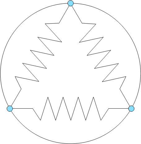

Here is the complete statement (I will omit the book it comes from as I dont't know the policy of this forum):
Consider ##l## equal point particles ##P_1, P_2, . . . , P_l(l > 2)## on a circle of radius #R$# and centre ##O##. All particles move without friction and the point ##P_i## is attracted by its neighbouring points ##P_{i−1}, P_{i+1}## with an elastic force (set ##P0= Pl##). Write down the potential of the system and prove that the configurations in which neighbouring rays form equal angles are equilibrium configurations. Study its stability (up to rotations). Compute the fundamental frequencies for ##l = 3##. What is the general procedure?
The picture you did matches my understanding of the problem. In my solution I have assumed ##d_0=0##, would it make any difference from the equilibrium standpoint? Until ##d_0## stays ##\leq R\sqrt{3}## I would say this may change the oscillating frequency but not the fact that an arrangement is stable or not (am I wrong?).

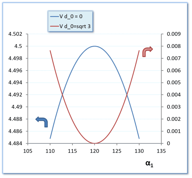

Yes ! A huge difference:
(figure for ##l=3, k=R=1##)
But I grant you that ##d_0=0## is more in agreement with the problem statement.

Thank you! I think you plotted my formula for ##V## when varying just one of the ##\alpha_i## right? Thinking about this, I think that the reason behind this, at least with ##l=3##, is that the constraint reaction component projected on the spring is stronger when the spring is extended, so the "strength" with which the spring pulls back (projected on the allowed trajectory) when extended actually tends to ##0## when the spring is a diameter of the circle, as it is fully neutralized by the costraint reaction...
Yes.

Things get complicated long before then.$$V=2kR^2\{\sum_{1}^{l-1}sin^2(\frac{\alpha_i}{2})+sin^2(\frac{2\pi-\sum_{1}^{l-1}\alpha_i}{2})\}$$ for ##l=3## and even distribution, with ##k=R=1## this simplifies to$$V=2 \sin^2\left (\frac{\alpha}{2}\right )+2\sin^2\left (\frac{\alpha}{2}\right )+2\sin^2\left (\frac{\alpha}{2}\right ) $$where ##\alpha = {2\over 3}\pi##.
a disturbance ##\varepsilon## of the even distribution gives $$\begin{align*}V&=2 \sin^2\left (\frac{\alpha+\varepsilon}{2}\right )+2\sin^2\left (\frac{\alpha}{2}\right )+2\sin^2\left (\frac{\alpha-\varepsilon}{2}\right ) \\ \ \\
&=\left(1-\cos\left(\alpha+\varepsilon\right) \right )
+\left(1- \cos\left(\alpha \right) \right )
+\left(1- \cos\left(\alpha-\varepsilon\right) \right ) \\ \ \\
&=3-\cos\alpha\left (1+2\cos\varepsilon \right ) = 3-3\cos\alpha + \varepsilon^2\cos\alpha +\mathcal{O} (\varepsilon^4)
\end{align*}
$$With ##\cos\alpha=-0.5## the blue parabola in the figure. Unstable.
Things get even more complicated when potential is not ##{1\over 2} kd^2## but ##{1\over 2} k(d-d_0)^2##. With a devious choice for ##d_0## the ##\varepsilon^2## term vanishes and a fourth power pops up !
