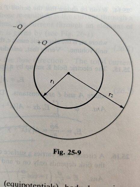

Potential on each of these concentric spherical shells
In summary: Q)/r_1$$$$= 0$$Similarly, I think the potential on outer shell should be the algebraic sum i.e. ##V_2=V_{22}+V_{21} =\frac {-kQ}{r_2} + \frac {kQ}{r_2}## which is the sum of potential on outer shell due to outer shell and potential on outer shell due to inner shell.
vcsharp2003
897
177
What would be the potentials ##V_1## and ##V_2## on the surface of the concentric conducting shells shown in diagram?
Potential at a point ##r_1## due to a point charge ##q## is ##V_1=\frac {kq} {{r_1}}##
Each spherical shell will contribute to potential on the surface of inner shell and the same will apply to outer shell.
Due to inner shell ##V_1 = \frac {kQ} {{r_1}}## and due to outer shell ##V_1 = \frac {-kQ} {r_1}##. Therefore potential on inner surface is zero.
But the answers are ##V_1 = \frac {kQ} {{r_1}}## and ##V_2 = \frac {-kQ} {{r_2}}## .

haruspex said:
What is the potential at the outer shell due to the outer shell?: How does potential vary inside an empty, uniformly charged, spherical shell?
(1) At outer shell, ##V_2 = \frac {-kQ} {r_2}##
(2) For a charged spherical shell, the potential inside is constant since E=0 inside a spherical shell due to Gauss's law. Negative of voltage gradient gives us electric field and since E= 0 inside a spherical shell so voltage gradient must be zero inside the shell i.e. voltage is constant inside the shell. So, ##V_{inside}= V_2## where ##V_2## is potential on the surface of outer shell.

vcsharp2003 said:
Will the charged inner shell also contribute to the potential on the outer shell?
Of course. The potential is the sum of the potentials of all charges.

Right, so the potential at the inner shell due to the charge on the outer shell is...?
Since inner shell is inside the outer shell, so it must be ##V_{12} = \frac {-kQ} {r_2}##

Also, I think the potential on inner shell should be the algebraic sum i.e. ##V_1= V_{11}+V_{12} = \frac {kQ}{r_1} + \frac {-kQ}{r_2}## which is the sum of potential on inner shell due to inner shell plus the potential on inner shell due to outer shell.
vcsharp2003 said:
Also, I think the potential on inner shell should be the algebraic sum ##V_1+V_2## i.e ## \frac {kQ_1}{r_1} + \frac {-kQ_2}{r_2}## which is the sum of potential on inner shell due to inner shell plus the potential on inner shell due to outer shell.
Yes. But I find your ##V_1, V_2## notation confusing. You seem to use it sometimes for the net potential at a shell and sometimes for the potential at a shell due only to the charge on that shell.
Likes Orodruin and vcsharp2003
Yes, you're right. I have changed my previous posts so the subscripts are like 11 or 12. 11 subscript would mean potential on inner shell due to inner shell and 12 would mean potential on inner shell due to outer shell.
It makes a lot of sense now. So, we can now say that $$V_1 -V_2$$
$$= ( \frac {kQ}{r_1} + \frac {-kQ}{r_2}) - (\frac {-kQ}{r_2} + \frac {kQ}{r_2})$$
$$= \frac {kQ}{r_1} - \frac {kQ}{r_2}$$
Which =0.
Likes vcsharp2003
haruspex said:
Which =0.
Yes. Did you mean that it's not correct result?
The result is correct. It is just that it is very easy to simplify to zero. This is an important sanity check since the potential at the outer shell is quite clearly zero (with the charge disribution being spherically symmetric with no net charge, the field outside the outer shell must be zero - hence no potential).
Likes vcsharp2003
$$= \frac {kQ}{r_1} - \frac {-kQ}{r_2}$$
You have a sign error in the last step.
Likes vcsharp2003
Yes, thanks for pointing it out. I have corrected the post for this. Once again thanks for all your great help. My textbook didn't explain it like this but simply reached the final result of ##V_1- V_2## saying we can assume a spherical charged shell to be like a point charge at center. It didn't make any sense in the book.
That's true for both the potential and the field anywhere outside the shell.
Likes vcsharp2003
The last part in the screen shot in post#17 that says "Thus," doesn't make sense to me, unless I am missing something.
You have not quoted q 24.4, nor its given solution, but if it finishes with your (corrected) equation in post #12 then it is just the same expression written without employing the 'k' abbreviation.
