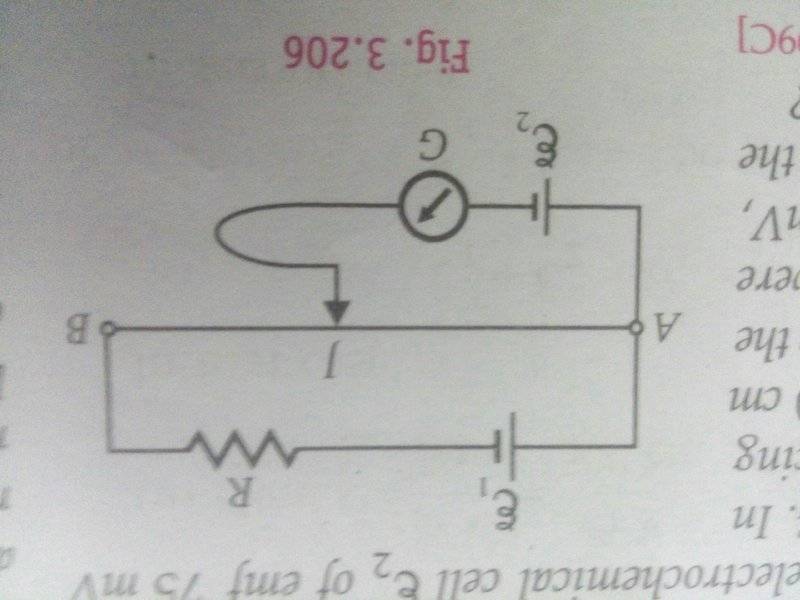

Potentiometer nulling voltages in a circuit
In summary, the potentiometer and the emf of cell E2 are unknown. Now to know the emf just finding the null point of the galvanometer is enough. Its because at that given length the potentiometer has the same potential as the cell. But why are they equal at null point?

They are pushing in opposite directions and balance out at the null point.

And here is your picture rightside-up, and cleaned up a bit.

No worries. Is the structure A-J-B supposed to be the potentiometer? If so, it sure is drawn in an unconventional way...
yea its the potentiometer

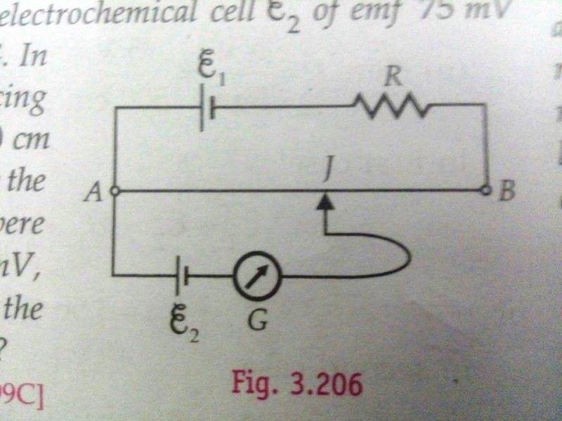

I'm not quite getting the question. The problem is that we do not know the relationship between the resistor in the upper circuit and the resistance of the potentiometer between ends A and B. or is that relationship given? That voltage divider will determine the null point for the potentiometer wiper, and without that relationship I don't think much can be said...
yea the value of the above resistor is given. but i don't understand why is that resistor required when the potentiometer wire itself has some resistance
It's not required, but it does complicate the problem. What is the relationship that is given?
ill be able to figure the value of the potential of the E2 cell... i just need to know why the potential difference AJ is equal to the cell E2 at null point
When you connect two batteries of the exact same potential in parallel, no current flows between them. That's because there is no potential difference to drive the current.
In the circuit above, start with the wiper not connected to the lower circuit. Using a voltmeter connected between A and J of the potentiometer, move the wiper J until you read the voltage E2 on the voltmeter. Now connect the galvanometer end of the lower circuit to J. This is the same situation as two parallel identical batteries. No current will flow through the bottom loop, because there is no potential difference to drive that extra current (so the galvanometer reads zero). All the voltage drop from A-J is caused by current in the upper loop still.
Hope that helps.

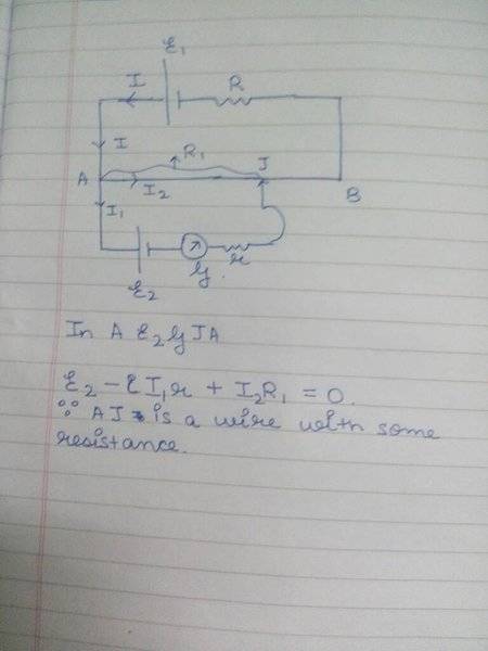

Instead, let's insert a small resistor in series with the galvanometer. Now you can write KCL equations for nodes A and J (make B ground), and you will be able to see how no current flows in the bottom loop when the voltage from A-J is equal to E2 (and the voltage drop across the bottom loop resistor is zero, since there is no current at that nulling point).
is this the kirchhoffs voltage equation you r talking bout?
then if its correct E2 = I2R1.
Correct. :smile:
so the ultimate conclusion is 2E2 = I1r. this means at null point E2 = 0. okk... so that's y I2R1 must equal E2 at null point. m i right?

No, E2 is a voltage. The current through the bottom leg is zero at the null point.
yea but voltage can be altered depending upon the internal resistance.. so its zero at null point... or else current would have flown
No, at the null point of the potentiometer, E2 is the same voltage it always is, and I1 is zero.
okk i got it... thanks for the help... you helped me a looooooot today

The null point is where there is no Potential Difference - that's why no current flows through the meter.

You find a point on the potentiometer wire such that the potential difference across that wire segment is equal to the emf of the unknown source. This is why there is zero potential difference across the meter as sophiecentaur said earlier.

If you have two water tanks, suspended with their water levels at equal heights above ground and you connect them, no water will flow because the gravitational potentials are the same. Same with a battery connected to a point with the same potential - no charge will flow.

I usually give this simple explanation for null deflection. If we take the conventional direction of current then the cell E1 causes a current to flow in the wire AB in anticlockwise direction whereas E2 does in clockwise direction. When we touch the jockey at different points on the wire these two opposing currents/emf s sends current through the wire. The point where they are equal and opposite gives the zero deflection. At this point the potential drop created by E1 and E2 are equal and opposite.
