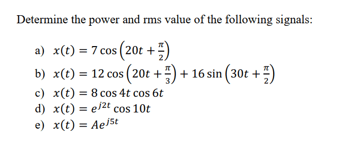

I need to calculate the power and RMS value of some equations. The problem is, I found two methods to do that and don't know which is the right method.
I have few equations to find the power and RMS value, but here is one equation.
$$x( t) \ =\ 7\cos\left( 20t+\frac{\pi }{2}\right),$$

Hi @JamesBennettBeta. Some of what you have written appears wrong/confusing. For example ##P_{rms} \ =\ \sqrt{P_{x}}## cannot be correct if “P” represents power, because the 2 sides of the equation would have different dimensions.
Maybe you are actually being asked to find the mean square value, and the rms value, of some function x(t). But that’s just a bit of a wild guess.
Can you post the complete, original question, word-for-word?
Likes JamesBennettBeta

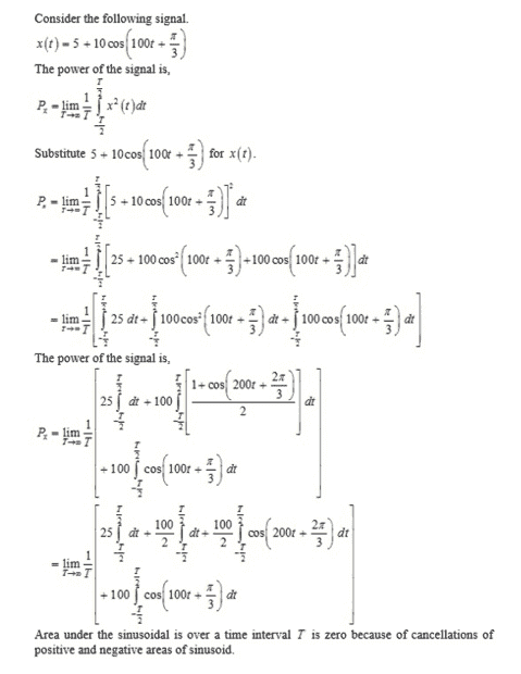

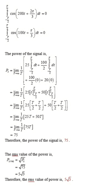

Thanks for your reply, the question is this. A problem raised since I have found two ways to solve this. Anyway, I don't know either one is correct or not.
Method #1
Method #2
Method two was explained in a video from an Indian Dr. I tried to solve the above problem using his way,
$$ \begin{array}{l}
5+10 cos \left( 100t+\frac{\pi }{3}\right)
Using\ the\ form\ A\ cos( \omega _{0} t\ +\ \theta )\\
Power\ of\ the\ signal,\\
Px\ =\ \frac{A^{2}}{2} =\frac{10^{2}}{4} \ =\ 50w\\
RMS\ value\ of\ the\ signal\\
P_{RMS} \ =\ \sqrt{50} \ =\ 5\sqrt{2}
\end{array}$$
The answers are completely different. I want to know what is the right method.

Your worked example is for x(t) = 5 + 10cos(100t + π/3). But this is not one of the questions you list (a – e). So I’m a bit confused a little by that.
Without checking your algebra detail, one point I note is that you appear to have incorrectly applied Method 2 when working out the power for x(t) = 5 + 10cos(100t + π/3).
I think that is the problem.
For a signal of the form:
x(t) = Acos(ωt + φ)
the average power is the average value of x² which is A²/2 (see point 2, above).
But for x(t) = 5 + 10cos(100t + π/3) you cannot take the average power to be A²/2 because of the constant term (5). For example the average power for
x(t) = 5 + 0.0001cos(100t + π/3) is a little over 5² = 25
(If that’s not clear, imagine a constant signal of x=5 units. The power is constant (25).)
And note you can't simply add the 25 to A²/2.
So method 2 will only work for some signals (but will save you a lot of time when correctly used). Method 1 will always work, but will require more work.
Sorry if that was a bit long-winded. Hope that it makes some sense!
