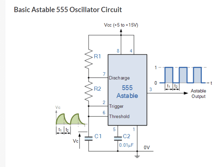

Does the timer555 consume power while the diode is off in the astable multivibrator??
Hi
I was wondering about the astable multivibrator .
Does the circuit consume power while the diode if off ?
If yes how much ?
Please explain in detail.
Thanks
Welcome to PF.
Yes it does.
What diode? Do you mean the collector of the discharge transistor, on pin 7 ?
There are three internal resistors used to generate the Vcc/3 and 2·Vcc/3 voltages for the two internal voltage comparators.
In the NE555, those resistors have a value of about 5k each, the three = 15k.
For Vcc = 15 volts, the current will be ≈1 mA. That current flows continuously.

@Baluncore already quoted the 1 mA over the three internal resistors.
The other internal cicuits will also draw some current here it has another 1 mA for a total of 2 mA
Perhaps the data sheet has more info. Best thing to do is of course measure.
The LED is external to the 555, so the LED power is not consumed by the 555.
The 555 effectively connects the LED to the supply rail.
The R+R+C external time setting circuit also consumes power.
The internal resistor chain, and the internal circuit bias, consume power.

So i should now multiply the value of Vcc with 2mA to find the power consumed by the circuit??
