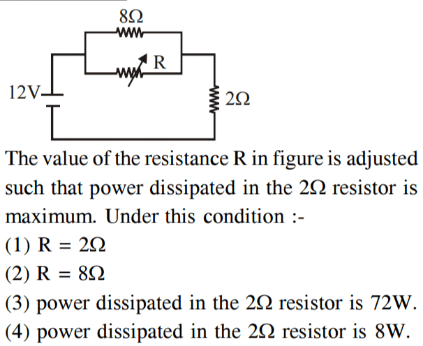

Power dissipated in the 2 Ohms resistor will be maximum when current is maximum .This will occur when total resistance is minimum .
If I think logically then I do get the right answer . But on trying to arrive at the result mathematically I think I am making some silly mistake .
Total resistance is Z = (10R+16)/(8+R)
For Z to be minimum , dz/dR = 0
Calculations give me a weird result 64 = 0
What is my mistake ?

Jahnavi said:
Power dissipated in the 2 Ohms resistor will be maximum when current is maximum .This will occur when total resistance is minimum.
Correct.
Correct.
But there is another restriction on R: R>=0
That's because the minimum (and maximum) Z occurs when R=-8 and the denominator goes to zero.
But the problem does not allow for a negative R.
Your maximum is not a point where the derivative is zero. It is a point at the edge of the allowed range for R (R cannot be negative).
How did you find that ?
You have R+8 in the denominator. Solve for R+8=0.
Are you implying that maximum or minimum can occur either at points where derivative is zero OR at end points of allowed domain ?
Sorry . But that's not how we find maximum/minimum value of an expression .
Well. It's how I found it.
The method you used will work for expressions that do not go to infinity - and which have derivatives.
The restrictions are actually more than that - but I think you want to keep the math at the secondary school level.
Yes. You have an example here.
Another example is the maximum of f(x)=x2 in the range of 0 to 2. Clearly the maximum is at x=2 where the derivative is not zero.
Likes Jahnavi
Yes. Look at the simple example of f(x) = x. The minimum of f(x) on 0 ≤ x ≤ 1 is at x = 0, and the maximum on that interval is at x=1. The derivative = 1 at both of those optimal points.
The theorem you are trying to (mis-)use is that if a differentiable function f(x) has a maximum (or a minimum) at some x in the OPEN interval a < x < b, then the derivative vanishes at x. On a CLOSED interval a ≤ x ≤ b, the derivative = 0 an an interior optimum, but not necessarily at an end-point optimum.
Likes Jahnavi
