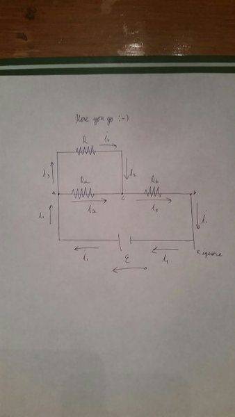

It's not clear how you've defined your currents, but the same total current should flow through a given resistor in both of your loop equations, so something's amiss with those equations. Can you describe (or better, show with a picture) the currents that you're using?
Likes Silverado
Thanks again. Your help is very much appreciated.
Silverado said:
Upper loop: -RI3 + RaI2 = 0
Lower loop: -RaI1 - RaI2 + E = 0
Okay, so it's just a typo in the second loop equation. The first term of the lower loop should be -RbI1, since only I1 flows through it according to your current definitions.
