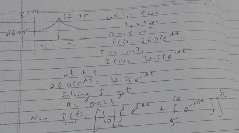

Since there is RLE load, current waveform is triangular. It is
Source current is
Average of I source. I used integration. Assumed Time period = 10 seconds. So T on = 5 seconds. (question says duty = 0.5)
So integrating I got average source current = 14.7 A
Average source voltage = 200 V
So input resistance = 200 / 14.7 = 13.6A
But I'm not able to get the first one. I get answer as 26.33 A But that is not even in the option.
I used formula square I(load) = square dc component (26.05) + square (rms of triangular waveform)

It says minimum is 32.75A and maximum is 26.05A. Something seems wrong, since we expect max > min.
So I'd say there's a printing error, maybe two, and in either the data or the answer options. Would (A) 26.17A satisfy you? If not, you could play around with various changes in the answers to see whether you can stumble across consistent values.

I got something like this:
I guess triangular waveform is justified when the inductance is very big. If resistance is very big then waveform of current = waveform of voltage = square.
I'm getting integrating value as 27.6A
How did you integrate so fast?
I haven't worked out an answer. I see insufficient information given to do so, in this instance.
The rising exponential, A(1-e-t/T) has magnitude A = (200-E)/R – 26.05
and T = L/R = unspecified
and passes through the point 6.7 at t=?? (5ms your nomination)
Too many unknowns to evaluate to a number, I think.
