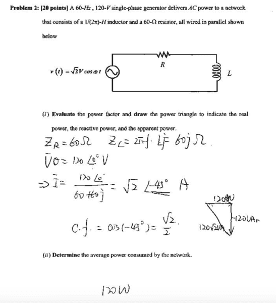

I asked the first professor that I agree with and he says that I am right and the other one is wrong. The other one claims it's just a "convention". I don't know what to do here and I am extremely frustrated because you can obviously see by definition that the complex power will have a positive angle.Here is another example from an old exam that does something similar. The power triangle they have or the complex power they found is not correct according to the definition of complex power. My professor (for a power and energy systems class ECE330@UIUC, taught over 40 years, department head, etc.,) said, "This ECE333 notation is contradictory to all legitimate textbooks on electric power and energy systems."

In the other problem in your OP, the question says R and L are wired in parallel (typo?) but the circuit drawn is a series circuit and your calculations there look correct to me. With which part of that question does your professor have a problem?
The problem comes up when you are looking for your complex power or asked to draw a power triangle. One professor (the one that is incorrect) said that drawing the power triangle with a positive angle is WRONG. He claims that for that first problem that I mention that the angle is negative. This can be easily proven wrong by using S=VI* (a definition) but he claims that it is a convention in his class to use θi-θv which is why he is getting that angle. because of that ridiculous "convention", which I can't seem to find anywhere else on the internet or in other books, he says that for that first problem the imaginary power(Q) is negative, which is wrong. I don't understand why he is using θi-θv. Mathematically, yes it does not make a difference. but the PF angle (PF = cos(θ)) that θ will determine whether it's lagging or leading and with his method you get the exact opposite of what yo would get doing it the way everyone else and every other book does.
Edit* and yes i assume that was a typo. But the solution for that problem is also wrong for the same reason. This is an exam from the proffesor that uses θi-θv to find his PF angle. That is why he says his PF is cos(-45) instead of cos (45). But the power triangle is wrong. It should have a positive angle. not negative.
Does your professor know this formula S=VI*? Has he ever used it in class?
Using this formula, it turns out that lagging VARs are positive and leading VARs are negative.
Your professor agrees that the current is 'lagging', but he thinks lagging current means negative VAR (sinΦ is negative according to his notation). This is OK as a convention, but he's probably the only one using it and it fails when you use S=VI* , as it contradicts his answer. According to his "convention", he would have to use S=IV* instead.
(I don't see the point in going against the convention though, that too in an EE class. The IEEE definition of complex power is S=VI*.)
So, for his class alone, take power factor angle as θiv and draw the power triangle accordingly (lagging VARs-negative and leading VARs-positive).
S=VI* would not work here, instead use S=IV*.
For the rest of your career as an EE, always use power factor angle as θvi and S=VI*.
