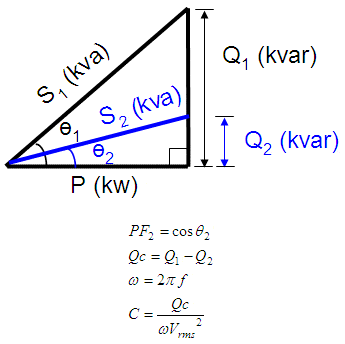

e.g. Say I have a lot of motors which bring the PF down & I add a static capacitor bank to correct the PF & now say, at night, 30% of the motors are idle but the capacitor bank is still fully online and hence the PF is now leading. Is that a problem?
I can imagine it is a problem for capacitor life but are there other concerns? Is overcorrection as bad as having an uncorrected inductive PF?
Yes it is:
Motors, transformers and other reactive components consume reactive power, while a capacitor is producing reactive power.
The PF = cos φ, where φ is the phaseshift between voltage and current. The optimal correction of the PF is when φ = 0 → cos φ = 1. When producing more reactive power than is consumed, φ will be negative → cos φ < 1.
In practice PF is corrected to about 0.85. If it raises overnight to 1.0 it's not a problem, but if it falls again due to that too much reactive power is produced, some of the capacitors will simply be switched off.

The power factor is a result of leading/lagging phase shift. The power factor itself is just a scalar(?) with no direction.
In practice the power grid will always consume reactive power, due to motors/transformers connected, so that the phase of the current will lag the phase of the voltage. Capacitors will produce reactive power, and will thus in pratice always increase the power factor.
In case of leading/lagging phase shift by turn, a synchronous motor could be used ( and are used ) for compensation: Magnetizing it too much, it will produce reactive power and vica versa, when connected to a grid. ( As a stand alone unit, it'll just produce more or less emf ). So in practice you can see a small building along a powerline, containing a synchronous motor with its shaft sawn of. It's doing no mechanical work, it's just there to produce ( or consume ) reactive power. This positive/negative production can be adjusted completely continuous(?).

In general the leading PF can cause local system stability issues (Voltage oscillations, flickering lights) , and increases wear and tear on the systems ( switches, contactors and motors) - the condition of excess capacitance (leading pf) causes large inrush currents during switching events.
So while I have not heard of a Utility Penalizing for excessive capacitance (in the billing for example) - they will come out to investigate as this will typically cause problems for the neighboring customers.
