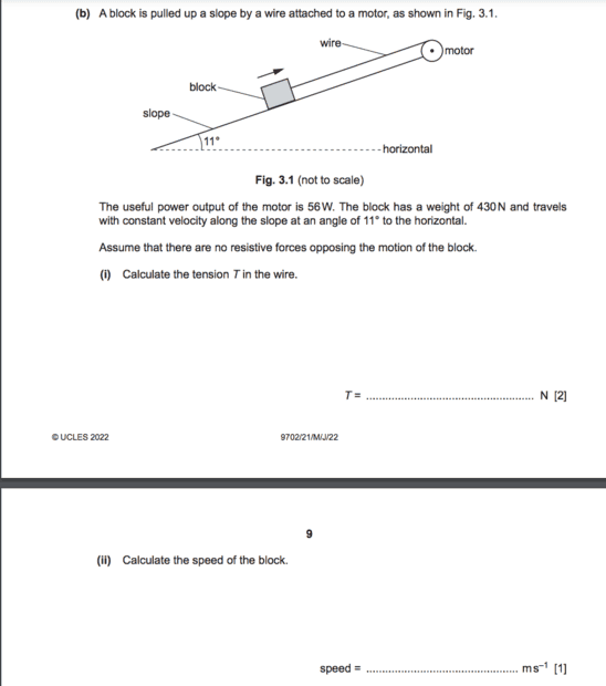

in finding the speed, do we use the tension force or the weight?
and what is f, wouldnt it be zero? as resultant force is zero
what does f in this equation mean?
p=fv
my attempt: i solved it all correct but i dont understand a few things mentioned above...
82.04 * v = 56
so i got v as 0.68 m/s which is correct
but i dont understand the concept...

i did
82.04 * v = 56
82.04 ?

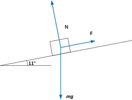

430 N *sin 11 for the component of weight along slope...

Use the net force acting on the body. Disregard
The work expended by the motor is transferred to the body though the tension in the rope. Nice save @MatinSAR

Two forces are acting on the object. Tension force and gravitional force.
$$\vec T + m \vec g = m \vec a=0$$
Can't you find tension force? Then how did you solve the question!

Wrong. This way tension force should be 430.But you wrote 82.04.
Likes erobz
You need to find tension force using object's weight. The only way is to use Newton's 2nd law for ##\vec a=0##.

no like, but the component of the weight along the slope would be equal to the tension but in opposite direction as no other force is acting in that direction... where is the newtons second law?
This is correct. There is no acceleration along the slope so according to N's 2nd law there is no net force. This means that ##T - mg\sin \theta## should be 0.

The tension force exists because the motor is pulling with force F. We can look at it from the point of view of the wire or of the motor.
The motor, presumably, is winding the wire onto a spool. The force it exerts is ##\vec F##, positive in the downslope direction. The velocity with which this is winding wire onto the spool is ##\vec v##, also positive in the downslope direction. The power is ##\vec F\cdot \vec v##, also positive.
From the wire's perspective, the force is positive upslope, but stationary, so the wire is not producing any power.

I definitely see three forces and write$$\vec T +m\vec g +\vec N = m\vec a = \vec 0$$

Picture what is going on inside the block. There is a drum turning, hauling in the wire. It exerts a force F on the wire, causing it to be drawn onto the drum with speed v. Both F and v act down the slope. The power required to do that is Fv.
