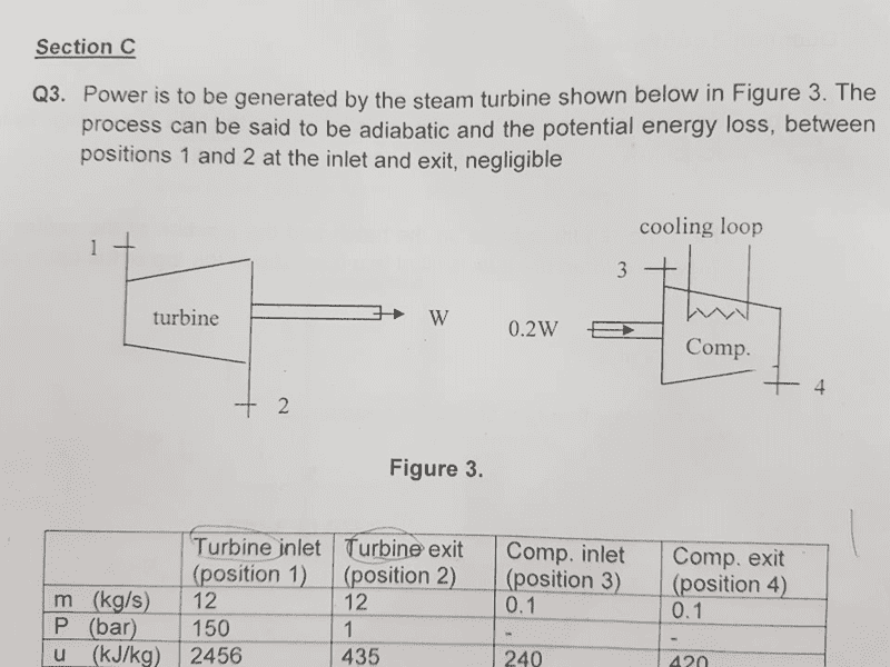

Hello,
I'm trying to solve a question, please help me.
Hi,
first of all, your question seems to be homework or preparation for an exam, therefore you should have asked it in the homework's section using the template (so don't be surprised if it will be moved). Secondly, to get help for homework, the guidlines demand to show a real attempt to solve the problem by yourself, therefore please show us what you gave done so far (and have a look at the homework template).
However, I suppose you can assume the steady state operation of the turbine (and the compressor). You'll need the first law of thermodynamics for open systems.

For this question, I'm not really sure where to start. That's why I couldn't show what I had done.
I know the equation for work when the process is adiabatic but it didn't help me much.
It would be nice if you could give several steps to start with, then I might be able to solve on my own.

Just click the link "FORUMS" in the header, the first block contains the homework section (template included, when you start a thread there).
You need the first law of thermodynamics for open systems, since mass enters/leaves the turbine it is not a closed system. The law reads
$$\delta Q +\delta W + \sum \left[\dot{m}_i \left(e_i+h_i \right] \right) = \Delta U + \Delta E $$,
##Q## ... heat
##W## ... work
##h## ... specific enthalpy
##e## ... specific external energy
##U## ...internal energy
##E## ... external energy
Now you can simply the formula with respect to your problem (i.e. which terms are equals zero?). Start with that, then you will see which data you need from the table.

I think by external energy you mean, in more familiar terminology, the sum of gravitational potential energy and kinetic energy.
Yes, I do. Is exernal energy the wrong or an uncommon expression? Probably I should look up the technical vocabulary ...
