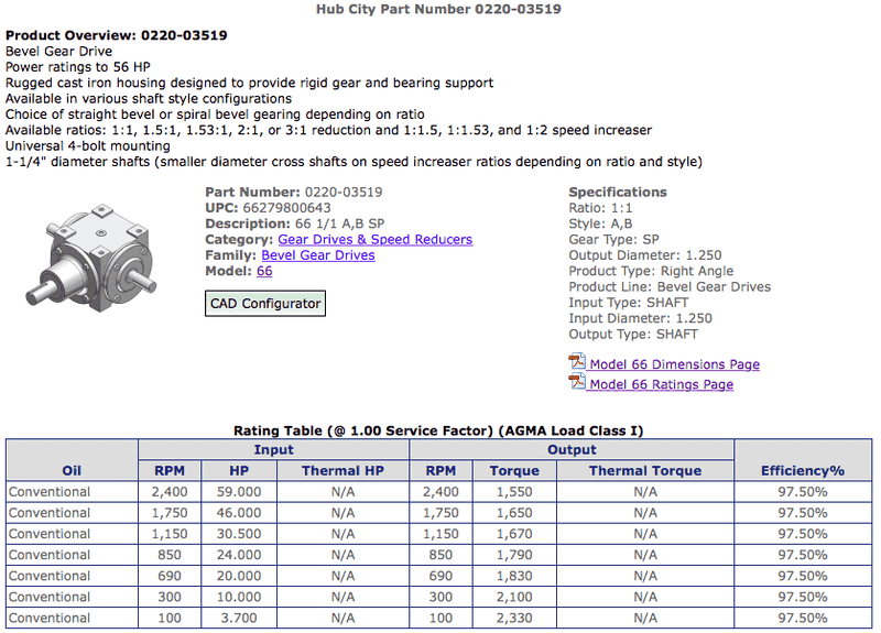

I'm trying to eyeball a standard duty nominal requirement for my gearbox specs. If I use a gearbox that can handle up to 59hp at 2 400rpm with 1 550lbs/inch of torque on the high side and 3,7hp at 100rpm with 2 330lbs/inch of torque on the lower side of the rating table, will it be enough to withstand those 6 riders standing on the pedals that are linked to a same shaft going into the gearbox ?

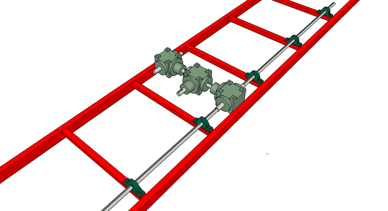

Hmmh, how could I phrase it in a more obvious way... I want to know if this gearbox will be strong enough to last many years of party bike duty. It will be positioned on one side of the vehicle, collecting up to 6 riders on the cross shaft and transmitting to another central gearbox, as shown in the rendering below. Effective rpm range for this application will be between 0 and 120 at the crank. I consider the max torque and hp per rider to be of 100lbs/ft at any rpm from 0 to 40. There will be plenty of shock load as well.

I do understand that concept. I should have said the torque that would be expected to make the whole thing move and then at which rate should I expect the bike to accelerate and the top speed I can expect to reach with a given max rpm and then how much continuous torque the gearbox will have to withstand when we are going uphill to a given steady rpm of the cranks.
I'm worried the gearbox will wear prematurely because of the sustained torque when we're in low rpm like going uphill or when the driver applies the brakes and people keep trying to pedal (drunk party people don't want to hear about braking, they want to pedal as fast as they can to reach the next bar haha). If I ask the owners to spend $3k on a gearbox setup instead of $1k on open spur gear and sprocket, I have to make sure it will last as long and longer than the spur gears and will be trouble-free and more quiet. But at the same time I'm trying to keep the floor of the vehicle as low as possible, meaning the bigger the gearbox, the higher the dance floor. And of course the weight, of the gearbox, the model 66 is already over 40lbs depending on the configuration, we want to keep the vehicle weight under a certain limit too.
Anyone can look at the gearbox specs and tell me if it will be fitted for the loads ?
