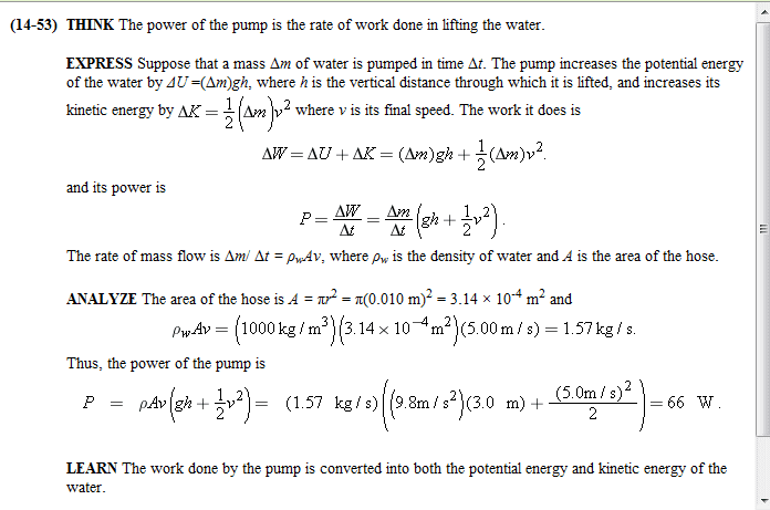

Water is pumped steadily out of a flooded basement at a speed of 5.5 m/s through a uniform hose of radius 1.0 cm. The hose passes out through a window to a street ditch 2.8 m above the waterline. What is the power of the pump?
We find the flow which is the area multiplied by the speed. Then we find the power which is the flow x the height (2.8 m) x gravitational acceleration x 1000 (fluid density). At least that's what my friend told me I should do. I had an answer of 47.4129 W but the answer is seemingly wrong. Can someone help me here, please?

I was checking through the problems on wileyplus and found this method:
The values are different, by the way (use the values from the problems statement I posted). I plugged the values and it gave me something around ~55 (or slightly more). The answer was also wrong. I don't think I my calculations are wrong - I triple-checked my computations.
I'm new to fluids as we did not cover it in high school.
Ah - that method also takes account that the pump has to accelerate the water, so gives it some kinetic energy. Your numbers are fine - 55.78J I get.
I think you need to look through your class notes for the definition you are given for the power of a pump. LawrenceC and I (and you, at first) have been working out just the rate of work against gravity alone.
