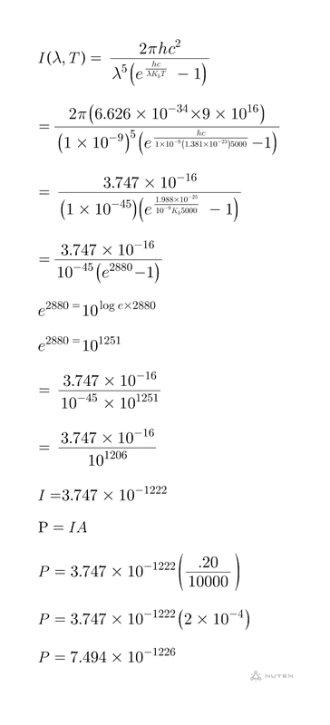

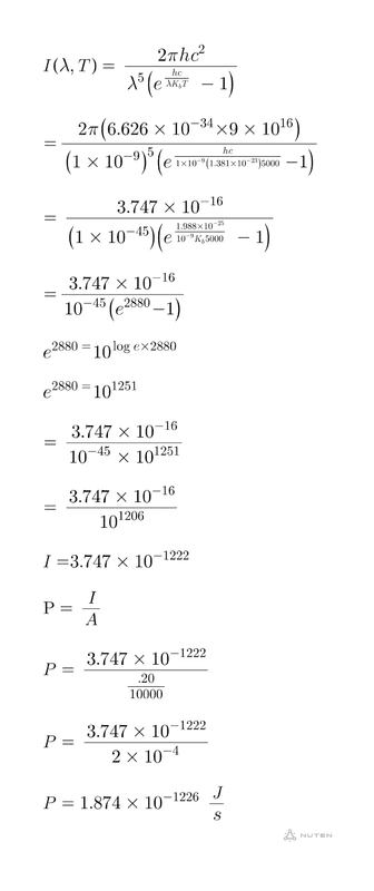

Consider a black body of surface area 20.0 cm.^2 and temperature 5 000 K. Find the spectral power per wavelength at 1.00 nm (an x or gamma ray.
See below
and where is the attempt at solution? This is an absolute requirement to get homework help.
It’s shown in the post, every step.

P=I/A? Are you sure?
And 10-1222/10-4=?
Duh. I fixed P = IA but still don’t have the right answer. Am I missing something about the phenomena or just another math error?

Do you know what the answer is supposed to be? I find it surprising to see a question in which the answer seems to be so infinitesimal, but I don't see any major error.
According to my textbook, Serway Beichner Physics for Scientists and engineers, the correct answer is 9.42 x 10 ^1226. The numerator must be right, just multiplying constants, and I got the right power of 10 in the denominator. Beats me. Thanks very much for feedback.
According to my textbook, Serway Beichner Physics for Scientists and engineers, the correct answer is 9.42 x 10 ^-1226 W/M. The numerator must be right, just multiplying constants, and I got the right power of 10 in the denominator. Beats me. Thanks very much for your feedback. The next step in the problem is to calculate the power at 5.00 nm. I’ll see how I do with that and reply in case there is a typo in the book.

You rounded the exponent of e to 2880, then rounded 2880 log10e to an integer also. To get the same leading digit as in the book you will need to keep a bit more precision. But in practical terms, when the power of ten is -1226, the leading digit of the mantissa is somewhat irrelevant. "Immeasurably small" should suffice.
Succeeding parts of the problem involve calculating P at longer wavelengths w/o the need to use logarithms for the solution, and I was able to get answers that agreed with the book.
As far as I can tell, it is mathematically impossible to come up with the right answer to the original post using logs. The numerator of 3.747 x 10^-16 is certainly correct and the denominator is just a power of 10, so the intensity is exactly 3.747 x some power of 10 and you can’t get to P = 9.42 x 10^-1226 W/m from there. Am I right?

In order to track down the error they may have made it might be good to do the problem correctly. Not a confidence builder otherwise.
Only because you rounded to a whole number in the exponent.
We can determine how accurate your inputs would need to be to get the 'correct' leading digits.
Suppose you have a fractional error δ in the exponent for e. The fractional error in ##e^x## is ##\frac{\Delta e^x}{e^x}=\Delta x=x\delta##. Since x is about 3000, ##\frac{\Delta e^x}{e^x}=3000\delta##. To get an answer accurate to two sig figs, all the factors in the x term will need to be accurate to about 6 sig figs. For hc and K, you only used four.
This is why it is somewhat crazy to worry about any sig figs in this answer. Merely getting the order of magnitude is good enough.
Likes Charles Link and hutchphd
Got it! Thanks for your patient explanation. As I have mentioned in earlier posts, I am a retired engineer, 78 years old, and learning something about modern physics is on my bucket list. I am self studying using a university level textbook for scientists and engineers.
