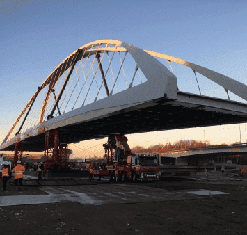

1,000,000 kilos is about this size
How about 1 million liters of water? That's a lot more practical. You pump the water uphill, then make electricity as it comes down. The round trip efficiency is about 80%. We call it pumped hydro power. For that, 5 kw is pretty small.
