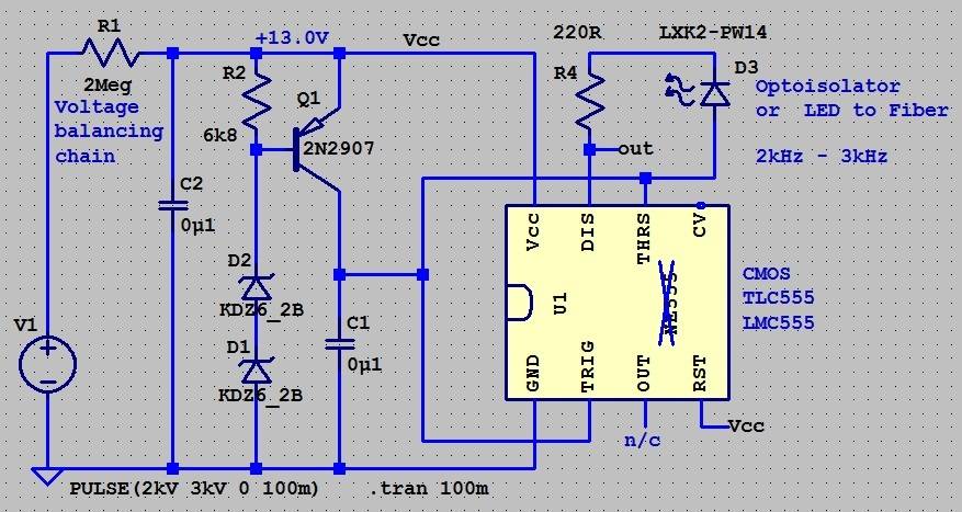

You have a voltage balancing chain with more than sufficient current to drive an LED or converter. There are many systems that could generate a voltage dependent frequency and communicate that through an opto-isolator or a fibre. The choice will be determined by the answers to these questions.
1. Is monitoring the individual capacitor voltages all you need to do?
2. Do you want Lo threshold and/or Hi threshold warnings, or do you want a 1% accurate value?
3. What is the min/max voltage range across a single capacitor?

My initial approach was to use fiber for communications from the voltage sensor to a central controller. I was looking at using the buck converter so I could reduce the current through the balancing resistors to reduce their losses. The idea of PoF was to get around draining the capacitors using the balancing resistors.
To your questions:
1) All I intend to do for now is voltage measurements. The voltage sensor is already designed so all I need to do is power the ICs. That is why I need 5 V, 20 mA.
2) I do need fairly accurate values.
3) The capacitors are rated for 1.5 kV each (3 kV equivalent) so I would like to measure at least 110% of the rated voltage. That puts the maximum voltage at 3.3 kV. The minimum operational voltage is 1.5 kV (750 V each) not considering startup or simply operating at lower voltages for testing.

There is no need for batteries. The divider chain provides more than enough current to run a regulator and current to frequency converter. By charging a capacitor with the voltage balancing current, it can be discharged through an LED to drive an optic fiber or an optoisolator. That way there is very little supply current required.
Here is an example circuit that produces close to 1 Hz per HV capacitor volt, ≈ 2 kHz.
A bipolar NE555 draws too much current, so it uses the CMOS TLC555 or LMC555.
The Q1 Vbe in series with two 6.2V zener diodes is a 13V shunt regulator = Vcc. The 6k8 resistor provides a steady 100 uA current to bias the zener diodes.
Most voltage balancing current flows through the collector of Q1, to charge C1. When C1 voltage reaches 8.67 volts the 555 discharges C1 to 4.33 volt through the LED.
That 20 mA discharge pulse through the LED does not come from the power supply. Current through the LED is limited by the R4 = 220R.
The V to F conversion is offset by the regulator bias and the 555 supply current.
