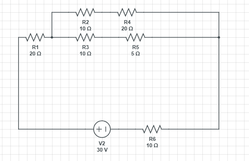

For the circuit shown below the 20-ohm resistor is immersed in water surrounded by insulating foam; the equivalent resistance through the circuit is 40 ohms. The current through it is 0.75A. What is the power dissipated through the 20 ohm resistor?
$$ P=I^2*R$$
$$ P=0.75^2*20$$
$$ P=11.25W$$
The solution to this problem gives 22.5W, why is the power dissipated through the resistor doubled here? Does the water or insulating foam affect the power at all? or is power calculated for the entire circuit?
The water and insulating foam do not affect the power dissipated, but they will certainly affect the temperature. The higher the insulation, the higher the steady-state temperature will be. Are there 2 resistors in the circuit? If 0.75 A is running through 40 ohms, then you can calculate the power from the equation you showed above. However, it should be P = I2 * R
Sorry forgot to give the picture
It looks like the answer they gave is wrong.
That would be the power dissipated in the whole circuit (all the resistors). Perhaps check the wording of the question?
