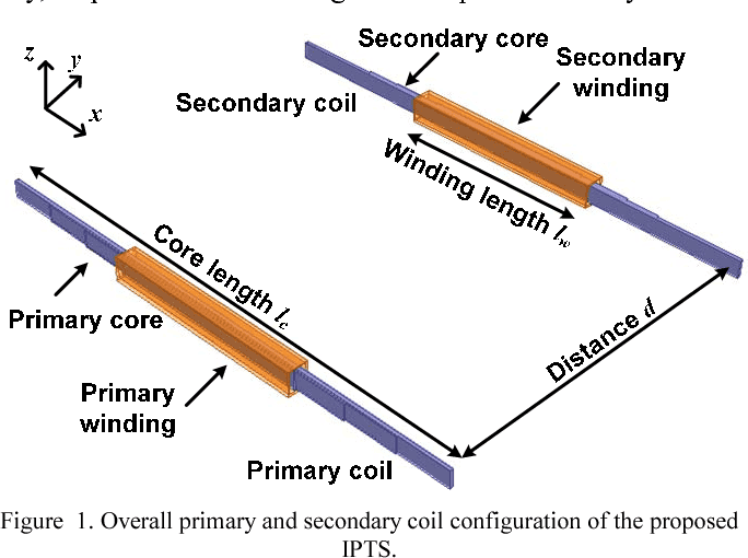

Good morning, I followed this thread https://www.physicsforums.com/threads/halbach-array-arrangement-for-a-transformer.979745/, about wireless power transmission using a Halbach array and @Baluncore answers are were very satisfying. Here are two configurations, the first is a resonant dipole coil system, but in my case non-resonant, and the second configuration involves a non-resonant array of Halbach electromagnets, in which of the two cases there is a greater transmission efficiency at frequencies of the order of khz at a distance double the length of the system, and in any case forming a more directional cone of magnetic lines.

good morning berkerman, yes then, the dipole coil resonant system is an excellent technology for transmitting energy wirelessly with high powers, but it is not very directive because the concentric field lines propagate in all directions, but I can use a backiron as a reflector. the halbach array is very directive but its implementation with electromagnets is complicated due to the variability of voltages. therefore I would only like to investigate which of the two solutions, with the necessary improvements, can transmit energy with greater efficiency for the same size. Attached is the dipole coil resonant system
as @Baluncore said, the halbach array needs many precautions, for example we cannot use AC for the arrangement, but pulsed DC with low levels of phase shifts and with the addition of high-speed diodes at the ends. so both solutions have strengths and weaknesses but I would like to understand which of the two is the best for the non-resonant WPT

Ok then berkerman, I would like to study wpt technology. The biggest problem is the decrease in efficiency as distance increases. Now I have two technologies, the DCRS and the halbach.
The DCRS uses the presence of the ferrite core to increase the intensity of the magnetic field but it is not very directive and therefore radiates its power in all directions to the detriment of the direction.
The halbach on the other hand is very directive but has various problems such as the use of AC and frequency. There is a patent on Google in which the magnetic cores of the halbach are joined together to make it a single solenoid.
Now I ask you, which of the two technologies (DCRS or Halbach) with the same length, current intensity and frequency, is able to transmit more efficiently at a distance double the length?
unfortunately I don't have access to IEEE explore, there is the only study on DCRS, the performance of DCRS is 36% at a distance equal to the length of the solenoid, while for Halbach with the same frequency and length it should double.

good morning berkemann yes, the powers are very low, I only want to transfer a few mW, my aim is to study which of the two systems is the best, so my aim is educational. the dimensions I take into consideration are: solenoid length 40 cm, current intensity 10 mA, frequency from 20 to 200 khz according to studies on other systems, I would like to study how much the efficiency is equivalent to 80 cm, therefore double the length. therefore the values are the same for both but the system changes (DCRS and Halbach) unfortunately there are no formulas, such as calculating the magnetization (volume) of the magnetic core. that's all

hi, I tried to buy the item but I had problems paying in dollars. However, I have seen many academic articles about dipoles and coils with sparse windings, and only the various tests are listed, with the various data, but I want to know the formulas and understand, also because in the end they are just dipoles, the main problem of the DCRS is to calculate the external magnetic field
