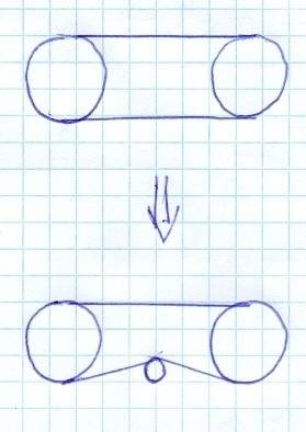

I haven't seen a sketch of the system, but anyway here is a suggestion:
The purpose is not to increase the tension, but to increase the angle wherein the belt is in connection with the wheel.
There is this "Eulers formula" to calculate at which torque the belt will slide.
Likes StevenBennett

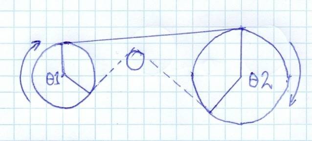

The image shows the system...
Small Diameter: 150mm
Large Diameter: 200mm
Apart Length: 600mm
and were working with the large pulley angle when calculating power
how will i know the angle of were the wheel will have to be?
so i guess this will be changing (v) which is 3.14? or the lap angle of the large pulley which is 3.225 Radians?
and will it just be trail and error?
Say you have calculated the angles θ1 and θ2:
You just draw the tangents ( stipled lines ) and place the small wheel as shown.

No, it should be possible to calculate θ1 and θ2. I'm not sure about the name of the law to be used ( I'm not a mechanical engineer ), but there is a law by which max torque can be calculated as a function of tension, angle and friction coefficient.

The lap angle as for the large pulley is θ2, shown in the figure in #4.

Maybe you should make the small wheel larger than drawn by me, otherwise your teacher will get angry with you, because you are bending the belt too much.:smile:
