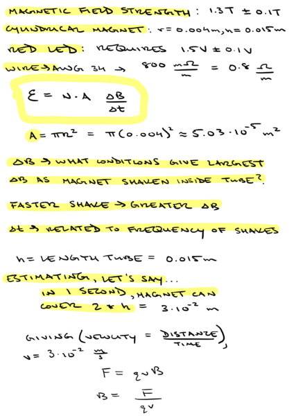

The problem with that is you don't know the flux from the magnet very well. You may be able to estimate it, though. Show us your initial calcs and we can comment on them. :smile:
https://imgur.com/a/YZMmnIq
So, I'm a little stuck here. I can't see how the resistance comes into play, or how I might solve for this magnetic field. Any tips?
If you're going to post an Image, it's best to use the UPLOAD feature.
Likes berkeman
Sorry, thank you.
Nevermind y’all. I managed to make it work! I was pretty excited. Thanks anyways

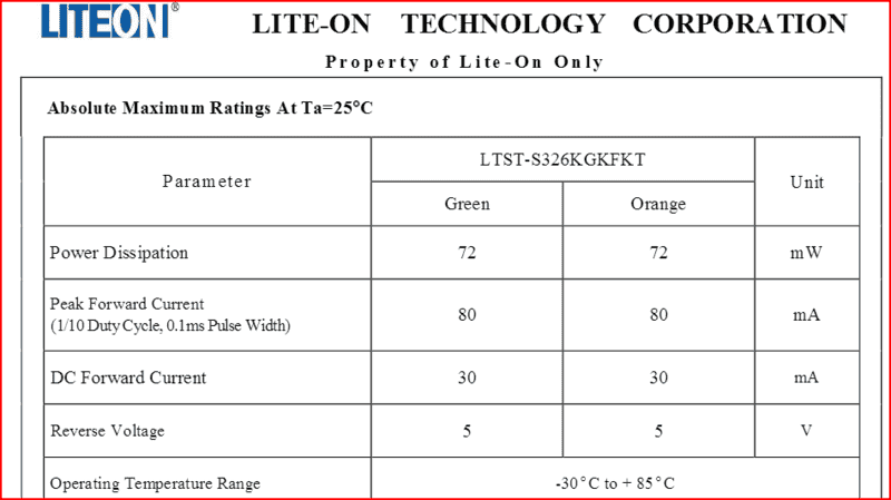

And to help you learn more about LEDs, the answer to my question about potential damage to the LED was regarding the Max Reverse Voltage that can be tolerated by the LED. From a typical datasheet:
https://www.mouser.com/ds/2/239/LTST-S326KGKFKT-1143909.pdf
