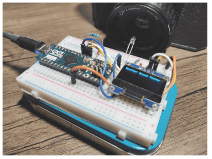

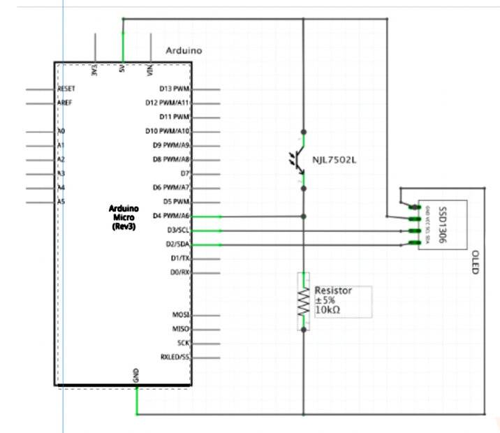

The only specifics I have are for one LED, alone, which requires 2.5-3 volts @ 20 mA. Far as I can tell, the rest of the circuit consists of a USB connector, an Arduino Micro microcontroller board, and a 4-pin OLED, requiring 2.8-5Volts (amps not indicated). The board itself draws 40 mA @ 7-10V. Photos of the circuit in operation show no other power source than USB.

If all you need to power is an Arduino and a LED, then I suggest match the voltage to the arduino and put a resistor in series with the LED.
Unless your LED is used for some very specific purpose, it will shine just fine within a certain range of voltages that don't need a LDO linear regulator but can be perfectly fine with a simple resistor.
As long as it's one LED and about 20mA a resistor dropping a couple of volts is manageable I think.

Birck said:
I'm putting together a shutter-speed testing device.
Can you say more about how you are going to measure the shutter speed? In your picture I think I see one Green LED aimed into the lens of your SLR camera, but I don't see anything to pick up the reflected light from that LED to let you know when the shutter is open or closed. Also, are you going to put a white reflector at the film plane (assuming it's a film SLR) to reflect the light that you shine into the lens when the shutter is open?
What is the function of the OLED? I see it in your schematic, but not in your picture...
I think the OLED should be the display
The green thing is the phototransistor, and there should be an additional light source behind the camera somewhere. I guess it's about measuring the time of illumination through the open (mechanical) camera => shutter speed
I've suggested LDOs because of the mention of low voltage (it's usually a tight squeeze to use anything else in an 5V system, at least at amateur/beginner level) but this setup so far indeed requires just a single resistor to set the current of the additional LED..
