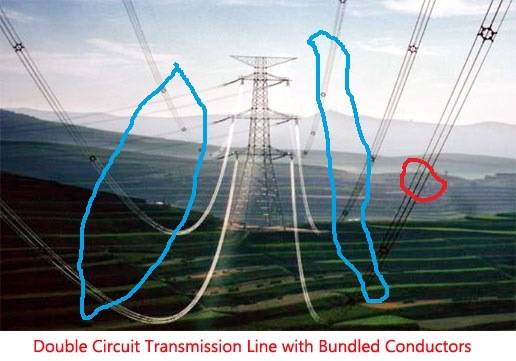

There are two possibilities to what you saw.
  1. Bundled conductors. We sometimes use 1, 2, 3 or 4 conductors per phase. That increases current capacity with the same voltage and it reduces corona losses (see picture below).
  2. Double circuit towers. We sometimes put two 3-phase circuits on the same transmission tower to save real estate. The capacity of a double circuit, is less than the capacity if they were on separate towers, but the costs are still favorable.
As @magoo said, we also have shield wires which protect from lightning. One or two shield wires per tower. They normally carry no current.
In the picture below you see both bundled conductors with 3 conductors per phase (circled in red) and double circuits (circled in blue).
Which did you see @gerts?

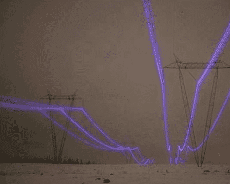

Corona discharge

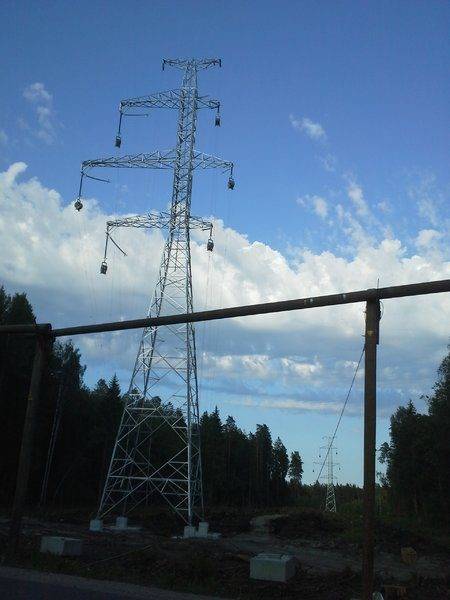

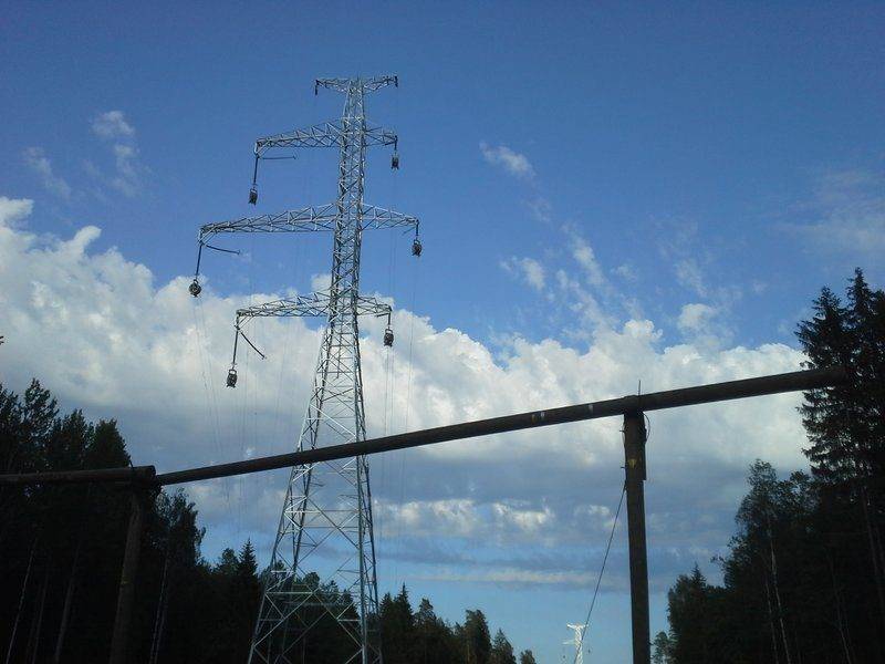

Now today I made some pics myself while driving by, and just as I read before about the project the two lines will go together on the same poles and will be used,
the old 110Kv line stands on separate poles and is still operational so @Baluncore if they wanted to keep it just as long as the new one is erected then they would not have made the new posts like this in order for them to have two lines simultaneously.
See the pictures, it is clear by looking at them that two lines (110Kv, and 330Kv) will be used in the future side by side. It is not just the isolators that are longer on the 330Kv side it is also the metal extension arms on which the isolators hang that are located further away from the vertical beams, look in the other side where the 110Kv line will be the arms are much shorter and also the isolators are shorter, this can only mean one thing , that the shorter side is for the lower voltage 110Kv line as it doesn't need such a big airgap, there won't be a chance to upgrade to a 330Kv line in the 110Kv side because the very metal pole is made such that there wouldn't be enough clearance between the wires and the grounded metal pole.What I want to understand is why have two different voltage lines running along the same path, what is the benefit?
as I can clearly understand that two different voltage lines means at every substation they need twice as much transformers, one set of traffos for 330Kv and another set for 110,
I guess in the end I will need to contact the energy company that builds these and ask them, because they run three large hydro stations and they also run the whole electrical infrastructure in my country.

The poled are not yet wires just erected and with isolators attached as can be seen but this doesn't change what i said in my previous post

interesting ... have never ever seen anything like that in Oz or NZ ...
Not just the length but also the larger and smaller cross pieces ... maybe it's a "Euro thing " ?

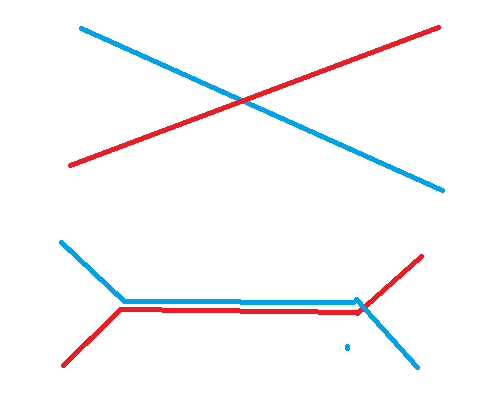

@davenn
Consider two independent lines at different voltages, such as in the top part of the picture below. Imagine them 100 miles long with towers every few hundred yards. Now imagine making at least part of the distance share the same path and the same towers as in the bottom half of the picture. Wouldn't that save money?
Lower cost and redundancy. Maybe the grid is not phase synchronised and requires two separated lines. Maybe the power belongs to different corporate bodies, or the 110kV is a backup for an industrial facility such as the pot line of an aluminium refinery or an older power station. It is also possible that the 330kV is national distribution while the 110kV is a supply between two smaller local areas.

The tower is constructed from galvanised angle iron. It is bolted together. The low voltage side could be upgraded if needed by replacing the arms and insulators.
You can be sure that the design engineer had a good economic reason to have the added complexity of asymmetric voltage and arm design. That reason may not be obvious. You may never find out exactly what particular combination of factors caused the decision.

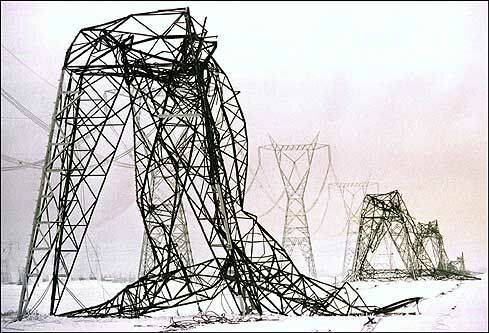

An ice storm in 1998 in the USA and Canada cut the wires in about 300000 places. Almost all places remained connected to the transmission grid, but it took 4 months to repair all the local distribution lines. Therefore, about 90% of the people in those areas had no blackout or were in the dark for only a few hours, while the unfortunate 10% had to wait weeks or months for restoration. Those are the kinds of numbers reliability engineers use to plan the grids.

If you look along a transmission line in a strong crosswind, you will see that the force on a wire due to the wind can be greater than the force due to gravity. The force on the tower is the vector sum of both windage and the weight of the wire.
When ice forms on conductors it increases both weight and windage, strong winds can then destroy the towers. How much heat do you need to generate in the wires to prevent icing? Who would have thought that there was an advantage gained by encouraging circulating reactive currents in cold weather?
