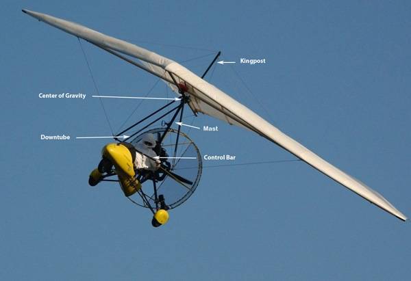

Seems like the most practical possibility would be a gasoline-powered ultralight aircraft with some folding/compacting capabilities. It would be a good idea to enclose the prop in a cage, and use computer flight and navigation controls, so the person using it did not need to be a skilled pilot.
That would still require some organization of places to take off & land, but things like sections of parking lots could be used for that, perhaps.
Something like this:
http://www.learner.org/jnorth/tm/crane/ultralight_weight_shift.html
