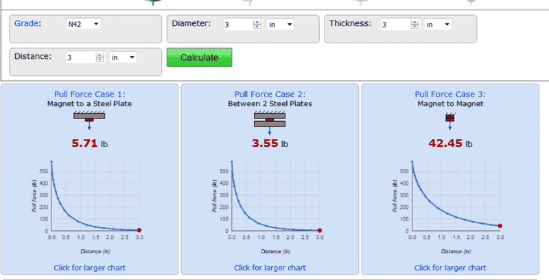

I see that the short range is the fundamental problem now! But is there a theoretical size in which we can make the magnet's size and thickness to effectuate the largest attraction range possible? According to a website [http://www.kjmagnetics.com/blog.asp?p=doubled-forces], the doubling up of the thickness of magnets by stacking them has a diminishing return because the furthest magnet away in the stacking adds little power because of its distance!? Is 3 inches really the thickness that is maximum for the additive effect for the attraction?? What if instead of stacking, a large magnet can be manufactured? How would this theoretically be attempted if one would want to make the largest magnet possible to induce a large effective distance of attraction?
According to the website, for a 3 inch diameter 3 inch thick magnet, the magnet at a distance of 3 inches will have a pulling force of only 5.71 pounds. How could this be increased significantly?? Could a 12 inch diameter 12 inch thick magnet increase the pull force to around 20 to 30 pounds? If the thickness can't be increased, would the increase in diameter make a larger portion of the pull then?
As your diagrams show, there is a curved 1/x like relationship between force and separation.
But as the buoyant box with vertical sides is pulled down into the water, the force required is linear, like 1–x.
Unfortunately the 1/x curve and the 1–x straight line do not fit very well.
