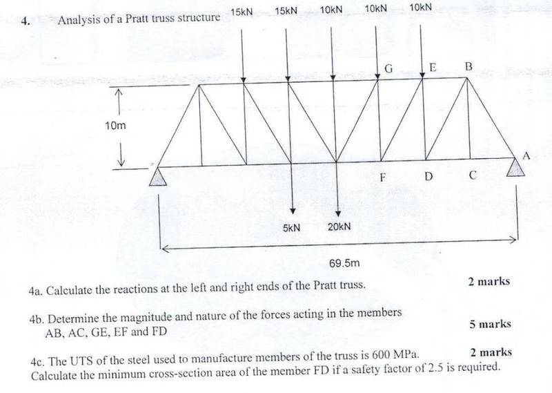

Been given an engineering assignment for school but not quite understanding how to answer all these questions.
Was told to use Method of Joints for the reactions on left and right.
And Method of Sections on the forces in the members.
Not sure how :(

Q1.
Consider the truss as a rigid body, the external forces acting on the truss are determinate, so by simply taking moments about each of the two supports, you should have no difficulty finding the reactions.
Q2.
Once the reaction at A is know, there are only three forces at A.
Resolve forces in the X- (horizontal) and Y- (vertical) directions. This will end up with two equations and two unknowns to find forces AB and AC. As it is customary, the bottom chord (AC) is in tension and the top chord is in compression.
BC has zero force, deduced by resolving forces in the Y-direction at joint AC. Therefore force CD equals AC.
Now consider joint B. Since force AB is known, and unknowns are BE and BD for which you can solve again by resolving forces in the X- and Y-directions.
Proceeding this way, joint by joint, you will be able to find all the unknowns requested.
Q3.
Since FD is part of the lower chord, it is in tension. Once you have calculated the force, the strength of the steel and the safety factor, it would be relatively easy to calculate the area required, since a tension member will not be subjected to buckling failure.

For question 1 i got 45kN for the Left support and 40kN for the right.
But now I am not too sure what to do for the 2nd question
Anyone got any ideas?
Very good. You have the correct answer for the reactions.
For question 2, you concentrate on joint A.
Identify the three forces that cross joint A. Compile the magnitude and direction of each. There should be one known force, and two unknowns (Fab and Fac). By resolving the three forces in the x and y directions, you should be able to find Fab and Fac. If you do not know the direction of the forces, assuming any direction (towards or away from A) and note it with an arrow. If the force comes out negative, you simply reverse the arrow.
Work that out for joint A, and if you succeed, you can proceed to other joints. If not, post what you have compiled, and tell me where you got stuck.

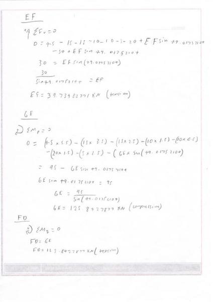

Ok this is my working out Members GE, FD, EF
Thanks mathmate.
Good!
You can also take moments of forces on the right side, so there will be less forces to take care of.
When you take moments, take about a joint, and not in the middle of a member.
The calculations for GE is incorrect because it should be 6 and not 6.5 if you take moments about the joint F.
