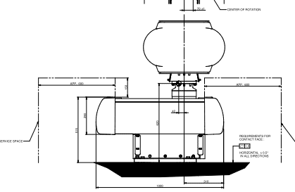

Precession in a 45 m high metalic antenna tower
In summary, the antenna + motor weights about 400 Kg, there is an excentricity between the centre of gravity of the antenna + motor and the centre of rotation of the anetnna which is 42 mm in the yy direction. After the antenna is fixed to a pedestal in the top of the tower (45 m), the centre of gravity of the whole structure (tower + antenna) is about 5 mm in the xx direction, and 23.84 mm, the centre of rotation of the antena is 148 mm in the yy direction. The free force given by:FS=Mr x ω^2 x e; eurocode 1 -parte 3, pag 39MR- mass of the
luislb
TL;DR Summary
In the top of th 45 m high mettalic tower is fixed an radar antenna + motor, the antenna pedestal is fixed in the geometrical centre of the tower (section 3x3), although the pedestal where the antenna is placed is in the geometric centre of the platform at 45 m, there is an excentricity between the centre of rotation and the centre of gravity of the tower. In this case there is a precession induced by the antenna in the whole angle mettalic tower.
1- the antenna + motor weights about 400 Kg (the helix weights about 170 Kg and has adiameter of 6.28 m, and the motor of the antenna weights 230Kgs), there is an excentricity between the centre of gravity of the antenna + motor and the centre of rotation of the anetnna which is 42 mm in the yy direction.
2- After the antenna is fixed to a pedestal in the top of the tower (45 m) the centre of gravity of the whole structure (tower + antenna) is about 5 mm in the xx direction, and 23.84 mm, the centre of rotation of the antena is 148 mm in the yy direction (see scheme).
3- The free force given by:
MR- mass of the rotor
ω - angular velocity
e- excentricity
The angular velocity is 60 rpm, the excentricity is about 171.84 mm, what is the MR, if the antenna is fixed to the tower?

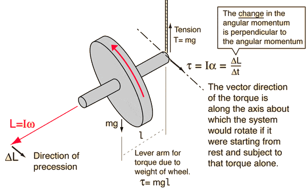

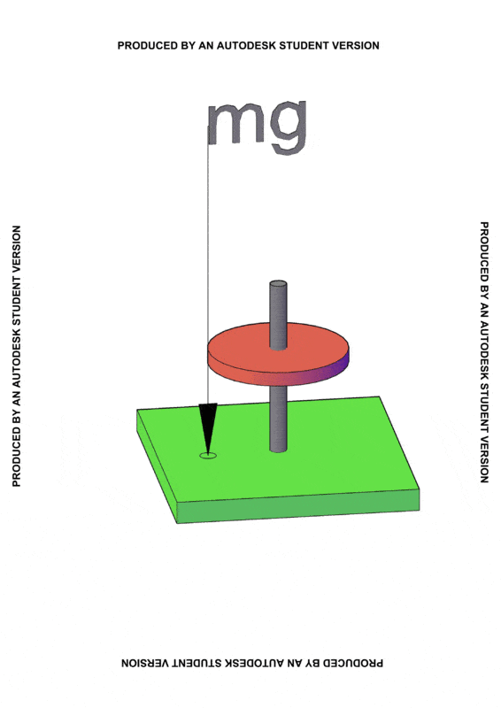

4- Because of the excentricity i discribed, there are a precession motion induced by the rotating atenna, what is the magnitude of this forces, and how they afect the tower? ( the angular moment of the helix of the antenna L= I ω, the torque is given by r x mg the velocity of the precession is given by r x mg/I.ω rad/s.)
5- In a simplified way the antenna + motor we can consider that the antenna is rotating fixed to a plate, and the are excentricity between the centre of rotation and centre of gravity induces precession what forces occur in this case, (see picture vertical axis), there is a relation between the a rotating vertical axis and horizontal axis( see pecture horizontal axis)?
6- If i formulate the problem through the conservation of the linear moment, between the L before ( antenna+ motor ) = L after (antenna + motor + tower) is it appropriated?thanks

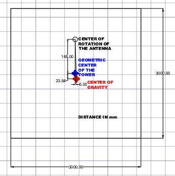

The antenna as two components the helix and the motor, and as you can see in the pictures, the centre of rotation CR of the antenna is displaced about 42 mm in the yy direction to the centre of gravity CG.
This antenna is placed in the pedestal located in the geometric centre of the tower GC, and when fixed to the tower there is an excentricity of the whole structure that is about 178 mm between the CR of the antenna and the CG of the whole structure ( antenna+ motor pedestal and tower).
1- There is a free force (unbalanced force) which is calculated for the formula that i mencioned in the first post, and it appears in eurocode, my doubt is, since the tower and the antenna are fixed together what mass do i consider in the formula?
2- Geometricaly there is a excentricity between the CR of the antenna and the CG of the whole structure, which causes precession or not?
thanks

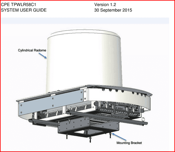

Why is there an eccentricity? That sounds like a design defect. Have you talked with the manufacturer of this subsystem about it? Or is this a home-brew combination of the motor + antenna?
And after you get the mechanical assembly balanced better, you could still consider a cylindrical radome structure on the top of the tower to eliminate the wind effects, IMO.

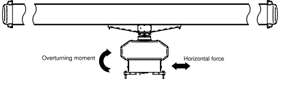

Regarding the wind force, in the case of the drag force, that produces imbalanced force, can be calculated through the resultant force, from the equilibrium of forces. How is the equilibrium forces?
The twisting moment only occurs when the arms of the antenna, are in the direction of the CR and the CG of the Tower?
FS
in he first step, i use only the mass od the arms to calculate Fs,that is the MR=170Kg and e (that is the distance between the CR and The CG of the antenna)?

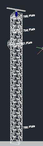

you´re the natural frequency of the tower is 1.54 Hz, much lower tha the 60 cps, it´s a mettalic tower made with angle profiles, S355 and S275.
I´m preforming a dinamic analisys where i consider 3 scenarios
1- FS with MR=170 Kg, aplly the force in the CR of the antenna and made the force varying direction from 22.5 to 22.5 until reach the 360º, the i preform a harmonic dinamic analises analysis. I got 2.4 cm of siplacement
2- The FS is 400 Kg, located in the CR, and preform a harmonic dinamic analisys where the velocity od the harmonic analisys is the 60 rpm. I got 5.7 max displacement.
3- The Fs1 is 400 apllied on the CR of the antena, and another Fss with the mass of platform at 45 m, with the mass MR of the platforma, and the force aplied on the GC of the platform and then prefrom a dinamic harmonic analisys, in the same way of the other scenarios. I got 6.8 max displacement.
What do you think of this method?

Hello Baluncore the natural frequncy of the tower assembled is 1.54 Hz ( i have a computer model). Yes the idea that change the frequency placing a water tank in the top of te tower moust likely with the form of a donut, because in the top of the platform is the pedestal of the antenna, or place the (TLD tunnde liquid damper ) underneth the platform au 45 m.
why the resonance is 2 Hz? 1 of the roatation of the tower added to a of wind grag force?
what do you think abou the analisys i´m preforming with the sofware i discribed in the JBA, answer?tank you for your help

thank you for your help, the antenna is from a danmark manufacturer, i´m sendind the caracterisctics for you, the problem is the forces/oscilation that induces in the tower.
The ideia do diminuish these effect is to place a tank of water in the top of the tower, a TLD ( Tunned liquid damper), it´s similar to the solution you recomend, how do i calibrate these cylindrical randome? it could be a great solution, although the tank of water seems to me more cheap.
Thanks
The radome is just to keep the wind forces off of the antenna (and to eliminate the change in the forces as the antenna rotates). It's just an RF-transparent shell.
High rotation rates are only needed for close range surveillance of fast targets. Coastal surveillance radar benefits from a slower scan as it looks out to 100 Nm. That becomes more true for sensitive 6+ metre long antenna arrays with a narrow beam.
So why is the antenna being operated at it's maximum specified rate of 60 RPM? Most marine radar rotates at about 26 RPM, T = 2.3 sec = 0.435 Hz. That is significantly further from the 1.58 Hz resonant frequency of the tower, so it will cause less imbalance movement.
Signal processing and digital storage displays are available, so I would ask the operators why the scanner must rotate at such a high speed. Reducing the rotation rate by a factor of two might resolve the tower oscillation problem, while increasing the radar resolution and sensitivity, and reducing the attention stress on the observer.
Designing and placing a 1 Hz TLD on the tower may psychologically lock the rotation rate to 60 RPM. That could prevent the scan rate from being reduced later to a more sensible rate with significantly improved surveillance performance.We do not know if a wind induced 2f problem is ever a significant problem during coastal hurricanes. Wind induced oscillation might become a problem if 2f came close to 1.58 Hz. That could occur when antenna rotation was close to f = 0.79 Hz = 47.4 RPM. If 2f was a problem then a symmetrical lenticular cover that rotates with the antenna element would reduce the cyclic variation in drag.
A full radome over the entire radar would not reduce the problem of the 1 Hz imbalance. As said before, it would increase the mass at the top of the tower, lowering the 1.58 Hz resonant frequency closer to the 1 Hz rotation imbalance.
