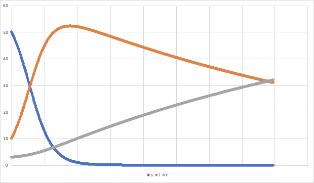

That's interesting, hadn't heard of this model! It appears to be$$\frac{dS}{dt} = -rSI$$$$\frac{dI}{dt} = rSI - \gamma I$$$$\frac{dR}{dt} = \gamma I$$I'll try and solve this on excel with Euler's method... since I don't think I'm going to get very far analytically!

This is what Excel produced for the Euler solutions to the SIR model, and it seems to give a reasonable model. Orange is infected, grey is recovered, blue is susceptible.

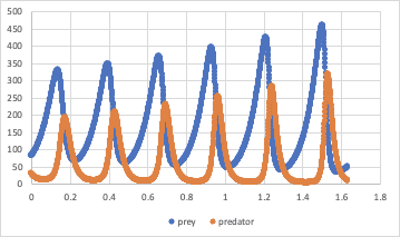

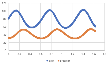

On second thoughts, I've just found the Euler solutions to the predator-prey model and they don't really look anything like the SIR model, reaffirming that it's probably not a good model at all for viruses.
I did, however, manage to produce some cool looking graphs:
This looks like the recovered cases are still able to be re-infected. That is currently an open question for the coronavirus, but I think the assumption is that a recovered person gains immunity. I think that would make these results look more like the SIR model.
Likes etotheipi
Yeah, I think the Lotka-Volterra model just isn't cut out for this for precisely that reason.
