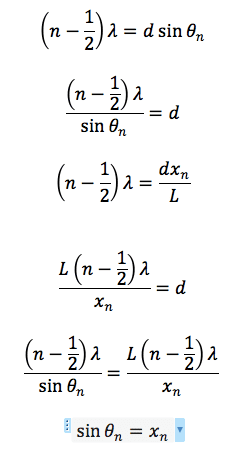

Where I am struggling is a second way to show how to alter d, without using their example. This is what I tried:
(n-1/2λ)=d sintheta n
Please see my attached work document for my work, it is very legible.
Basically I rearranged (n-1/2)λ=dx/L for D, and substituted for d (n-1/2)λ=d sintheta n, then rearranged for x. I got:
L(sintheta) = x
How does that make sense? If the angle is 90 then the distance of the fringes will be equal to the distance from the screen to the fringes? What am I doing wrong?

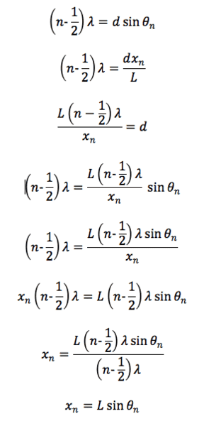

Updating my second equation because I realized it was out of order and didn't make sense anyway
I still got the same answer though.
L(sintheta) = x
Perhaps you can consider distance between both slits as a variable; I think equation 3 is the one describing that relationship. the "d" in equation 3 is not distance to screen, but rather distance between both slits if I am interpreting this correctly.
oh my goodness I am insane and I have no idea how I missed the solution right in front of my nose. thank you for your reply. I had compared d already.
so I had the right answer earlier and for some reason late at night chose to delete it and redo it... I deleted my statement about the L variable, the distance from the slits to the screen! sorry for posting this and thanks for your time.
