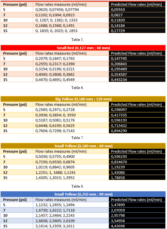

I provide the tables that I have done with the measured flow rates and the predicted ones using the Haggen-Poiseuille equation. The values with the capillary of 0,127mm and 150mm are almost a perfect match. The 0,127mm and 60mm are good too and then I starts getting worse with the values measured being smaller than the predicted (the logic would be the opposite even if the fluid is non-Newtonian, specially at higher pressures, right?)

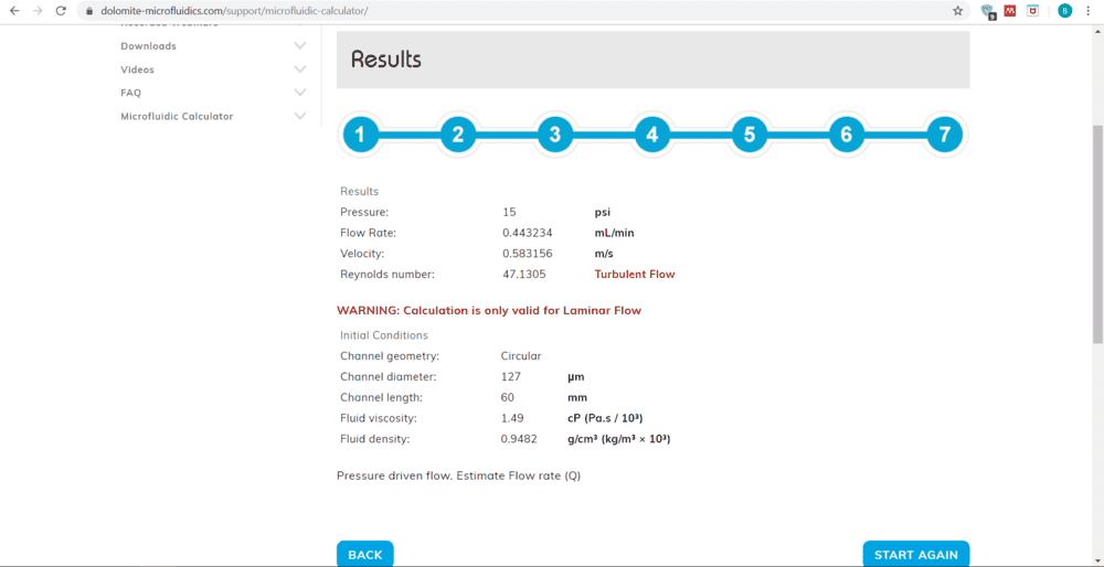

Reynolds numbers at the highest pressure (15 psi) (viscosity of THF:Water (3:2) equals to 1,490 cP; density: 948,2 kg/m^3) of each capillary (using https://www.dolomite-microfluidics.com/support/microfluidic-calculator/):
-> 0,127mm and 150mm long capillary: Reynolds number given by the online flow calculator = 18,8522 (it says it is laminar flow)
-> 0,127mm and 60mm long capillary: Reynolds number = 47,1305 ( the calculator/software tells me that I have here turbulence, although I know that theoretical, flows are laminar until having 2000 of Reynolds number)
-> 0,180mm and 120mm long capillary: Reynolds number = 67,0932 (it says I have turbulent flow)
-> 0,180mm and 60mm long capillary: Reynolds number = 134,186 (it says I have turbulent flow)
-> 0,250mm and 90mm long capillary: Reynolds number = 239,673 (it says I have turbulent flow)

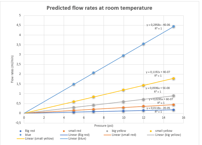

I provide also the graphs of the measured values (black graphic) and the predicted values (white one):

I confirm your calculations, and, for those Reynolds numbers, the flow is obviously not turbulent. The linearity of the pressure drop vs flow rate graph confirms that the behavior is Newtonian. This leaves, in my judgment, the capillary diameters as the villain. How sure are you of the accuracy of the capillary diameters? For example, if the largest diameter were 225 instead of 250, that would remove the discrepancy there. And if the 180 was instead 168, that would remove the discrepancy there.

In my judgment, the flow measurements provide an accurate indirect measurement of the diameters.

Oh, ideed, I never thought of that. The only thing that still "annoys" me is the calculator saying that I have turbulent flows:
But what you said indeed makes sense, or better, it is the only thing that makes sense, it explains the discrepancies.

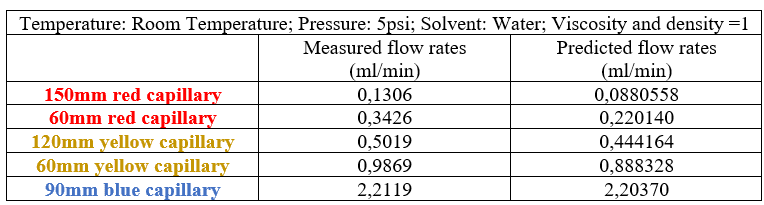

I went to search for data with another solvent (water) and I found this:
It doesn't help me because know I got more accurate measurments in the bigger capillaries ahah. Oh well... ahah.
But I think this values may not be significant because I only measured once and was during my first time with the system, I could have putted the pressure not exactly at 5psi, I don't know.
So I think I'm going to stick with the logic of the diameteres of the capillaries not being exact and solvent evaporation.
