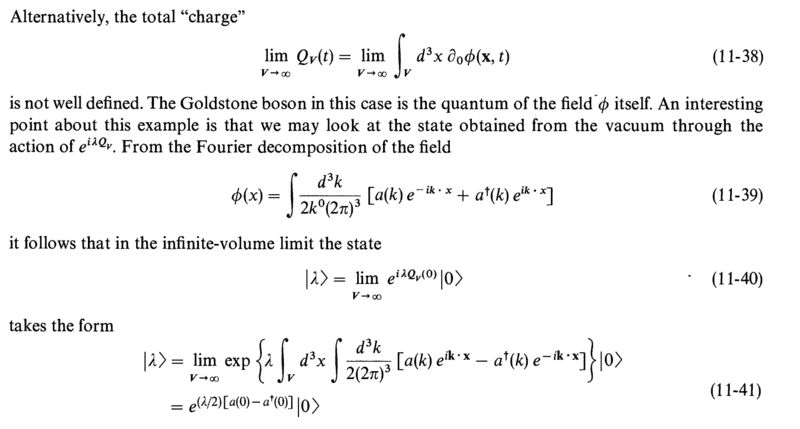

Great, thanks a lot. My confusion initially came from when I was looking through Itzykson's QFT book and came upon this discussion on pg. 521:
Specifically, looking at how the scalar field is quantized in equation (11.39), it seems to me that if we used Peskin's definition of normalization, then the energy term wouldn't cancel out after we take the derivative with respect to time and thus we couldn't evaluate the integral in equation (11.41) right (since the energy term is also necessarily a function of the spatial coordinates of momentum).
It depends, at which place you want to have it convenient. If you want the creation and annihilation operators to create momentum eigenstates normalized to 1, you need the ##1/\sqrt{2 E_{\vec{p}}}## factors in the mode decomposition. If you want manifestly covariant integrals in the mode decomposition you need the ##1/(2 E_{\vec{p}})## factors. That's because ##\mathrm{d}^2 p/(2 E_{\vec{p}})## is mainfestly Lorentz invariant.
The correct factor of the field is of course always uniquely defined by the equal-time (anti-)commutator relations,
$$[\hat{\Phi}(t,\vec{x}),\hat{\Pi}(t,\vec{y})]=\mathrm{i} \delta^{(3)}(\vec{x}-\vec{y}).$$
