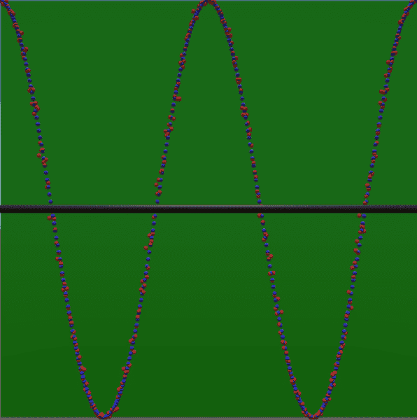

I have previously posted Preserving local realism in the EPR experiment
I have since given up on simulating local realism since I now understand it is impossible. However I have not given up on causality. Attached is code that simulates the EPR experiment and gives the same result as what quantum mechanics predicts.
The algorithm is simple and inspired by the quantum eraser experiment Quantum_eraser_experiment
In other words, I could only understand the result of the quantum eraser experiment by rationalizing it with the following algorithm:
The first entangled photon interacts with its polarizer and immediately gives the other entangled photon the result of its interaction. Other than this, the entangled photons interact normally with their respective polarizers.
This algorithm preserves causality when simulating the EPR and quantum eraser experiments and perhaps it would be correct to say it also preserves local reality since the mechanism is instant or FTL. Or am I twisting definitions here?
Here is the code that simulates this.

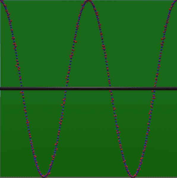

The result of the simulation gives the same result as quantum mechanics regardless of what angles I use for the respective polarizers. The blue spheres represent the quantum mechanics prediction and the red spheres represent the result of the simulation.
I assume that this type of mechanism has been explored by others. What are the problems with it?

Yes, the simulation calculates the coincidences and graphs them.
I don't have the entire code of the simulation posted, but just what was important. I could upload the entire simulation to github, but it would take me some time and I don't know that anyone would care. The simulation fixes one of the polarizer angles and then runs through a range of the other polarizer angles. It does not matter what angle I use for the fixed polarizer and always results in the same coincidences as predicted by quantum mechanics.
Anyone should be able to take the code I posted, modify it for their language of choice, and get the same outcome I have. In other words, I posted everything one would need to know to reproduce the same result.

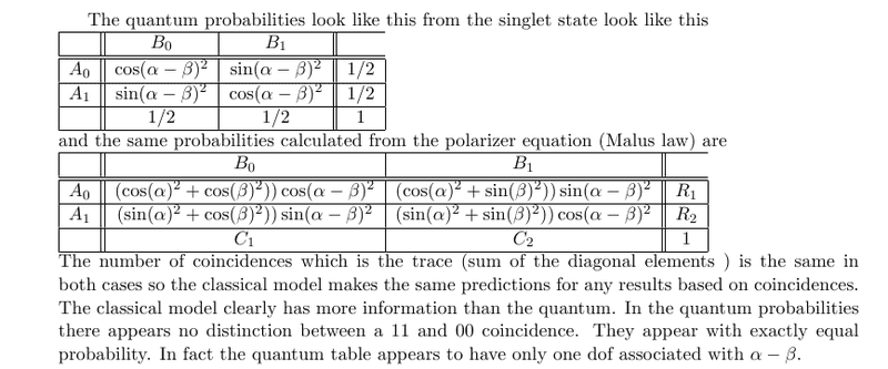

I've already done a simulation and analysis that satisfies me and key thing is that the first photon to interact will cause the other one to have the polarization of the first photons filter. So now the other end has information about the first interaction. I also find that this gives the correct coincidence probabilities. But, the contingency tables predicted by the models are shown in the pic ( I couldn't get the Latex to display).
Can you calculate those probabilities algebraically from your simulation ?
(There is a factor of 1/2 missing in those tables. Please compensate !)

OK, have a look at the tables in the picture in post#5. In the cells (2x2) there are probablilities. The marginal probabilities are the sums of two of the inner cells ( a row or a column).
My latest thought is that I should include the intial polarization ##\theta_0## in the cells so that for instance ##P(00;\alpha,\beta)## becomes ##(\cos(\alpha-\theta_0)^2+\cos(\beta-\theta_0)^2)\cos(\alpha-\beta)^2 ##
Now I should be able to integrate out the variate ##\theta_0 \in[0..2\pi]## and get rid of the terms with ##\theta_0##.

Are the four cells supposed to be probabilities of different outcomes, ##P(00 | \alpha \beta)##, ##P(01 | \alpha \beta)##, ##P(10 | \alpha \beta)##, ##P(11 | \alpha \beta)## for the same settings ##\alpha##, ##\beta##? If so (and this would be confusing, since ##A_{0}##, ##A_{1}##, ##B_{0}##, and ##B_{1}## normally refer to different measurements in the literature) then the probabilities in the second table are not possible according to quantum theory. Why would you want to simulate them?
Yes, those are the probabilities of the outcomes as calculated. ##A_0## meaning A has a '0' and so on.
I find your notation difficult. I want to write ##P(x,y;\alpha, \beta)## for the probability of getting outcome ##xy \in [00,01,10.11]## given settings ##\alpha, \beta##.
Expanding thus* ##P(x,y;\alpha, \beta)=P(x;\alpha)P(y;\alpha,\beta)## we get the probabilities in the table. My problem all along has been that this is not the singlet state for the reasons I've given.
Can you calculate those probabilities algebraically from your simulation ?View attachment 219650
I am not quite following. Are you satisfied that my simulation produces the correct result in all scenarios of the EPR experiment? If not, can you give a specific example of where you think the simulation will produce the wrong result? Thanks.

Your presentation is very sparse. What type of experiment do you simulate - beam splitting polarizers or one-port polarizers ?
What does the graph show ? It has no captions.

My intent of the simulation was to support the idea that the EPR experiment can be simulated in a deterministic manner with cause and effect. Yes, the main feature of the simulation is that the first photon that interacts with its polarizer, projects its state from the interaction to the other photon that is yet to reach its polarizer. This seemed like a necessity because the quantum eraser experiment seems to imply you can change the result of the other side, no matter how far away, no matter how much time later, you insert the change in the experiment. That defies common sense! Leading me to think that the only way it can happen is with the projection mechanism.
I think the EPR uses what is called a linear polarizer. Other than that, I did not think it was important for the experiment. So I would say I am simulating a linear polarizer.
Sorry about the bad graph and poor explanation. It is one of the outputs of the simulation. It is a plot of coincidence percent between the polarizers in the experiment. The polarizer angle of one side is fixed and the other side goes from 0 to 360. The blue dots are what the equation predicts and the red dots are what the simulation predicts. It helps me determine quickly if I am on the wrong track, but I also run, compare, and print out a few other experiment scenarios of different angles as well as all of the counts.
