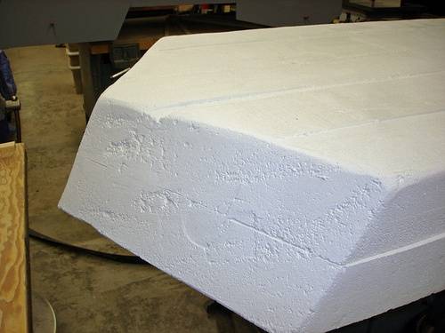

Then get some Styrofoam
and carve it in such a way so that I would be able to insert the half of the coke bottle I'm using into it then make a cover out of styrofoam to make an airtight as possible cover for it to prevent air and moisture from getting down into it.
Afterwards then wrap the entire thing with foil to reflect any radiant energy.
What are your thoughts on it?
Would it be able to keep the milk preserved for the given time period?
why cut the bottle? it would hold the milk far better than the styrofoam and cylinder.
Use the styrofoam to surround the bottle instead.
