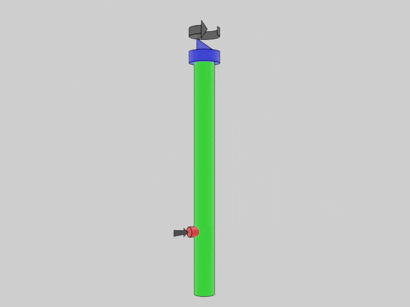

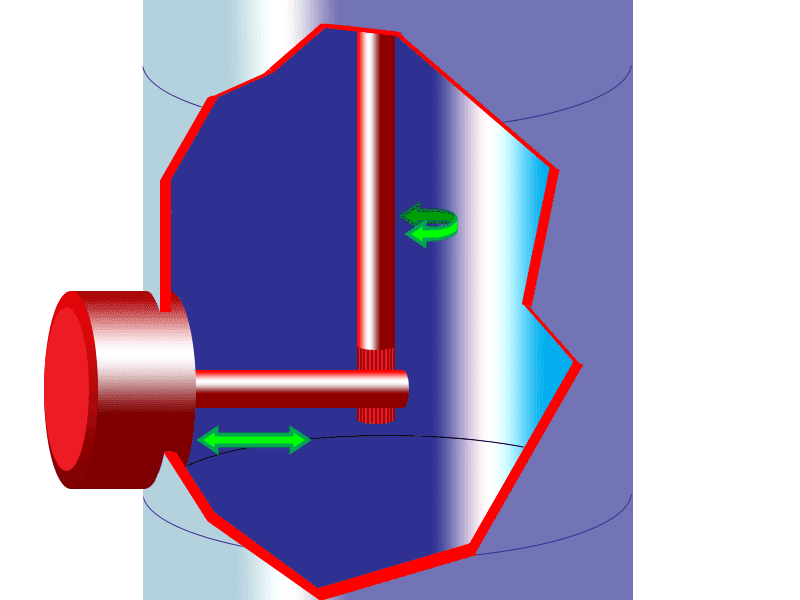

Here's a sketch of the desired device:
Proportionally and size-wise it shoud be similar to a pen. Rotation should be around 10 degrees, not much.
The red object is the button, the green is the housing and blue is the rotating part.
I vaguely remember having a toy like this as a kid where the plastic top of the stick would rotate when a button on the stick was pressed.
I think it should be done with a tiny spiral shaped spring (like in old dial telephones or cranked music boxes) for the rotating part to be squeezed and rotate the rotating blue piece and when the button is released have the spring rotate the blue piece back. Since the button is so far from the rotating part I'm not sure a lever under the button + a single gear attached to the tiny spring would suffice.
Any ideas are welcome.

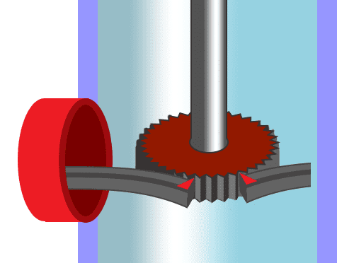

How many times must it operate before needing to be reset?
Just a few? A spring will work.

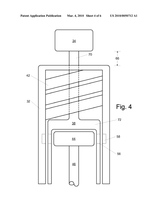

Multiple 360 degree rotations, 10 degrees at a time? The mechanical press of the button may be enough to move the machinery to trigger a rotation.
Here is a super simple mechanism that has all the moving parts in one place.
I haven't detailed the escapement here.
A push of the button engages the 36 tooth gear and turns it one tooth. When the button is released the other stop prevents the gear from slipping back.

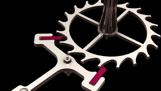

Below is an example of an escapement to illustrate how the tooth angles facilitate one-way ratcheting.
It does not need to be this complex. For example, it doesn't need the rocker pivot. Bendy plastic arms like in my illo above will suffice.
Likes faxibe and anorlunda

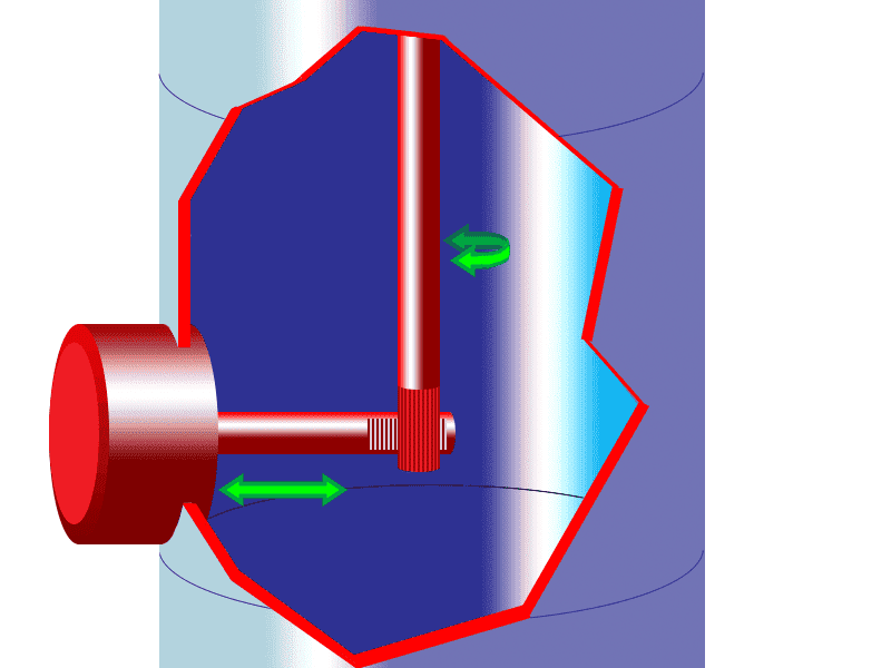

Thanks all. Sorry that I wasn't clear enough in my OP. I need the press to engage a rotation, and the release of the button to cause rotation back to the original angle. The rotation can't keep incrementing after each press and not rotate back upon button release. That's where the need for spring comes.
I'm adding an animated sketch.

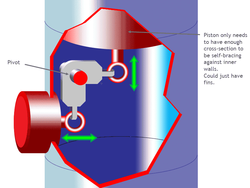

Oh. That's way easy. Just levers. All you're doing is converting a motion by 90 degrees, and at a 1:1 ratio, to-boot.
The only spring you'll need is in the button itself, to ... er ... de-depress it.
All your levers will be slaved to it, so when it pops back out, it will also de-rotate the head.What do you need our help with?
Not really, the blue part is rotational motion if you pay attention to the arrows.
I paid attention to the arrows...
It doesn't matter. It's joined with a connection that can move and pivot freely - like two links of a chain - except their outer ends are embedded in your moving parts.
If you push one end, the other end will move, constrained by what it's attached to.
Anything like this:
Rotational or pivotal movement of either end doesn't matter. You're pushing/pulling only.
The rim of the head will be pushed laterally, the rim constrained by its own central pivot.
Likes faxibe
These are simply schematics, to show you where attachment points are, and how components will move, but I assure you it will do the job.
Did you want me to flesh it out a little?
Likes faxibe

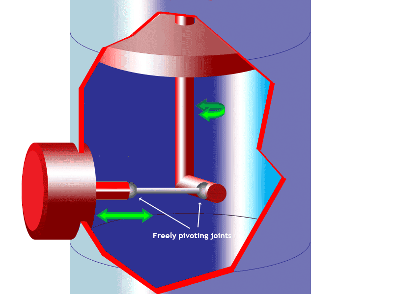

An even simpler approach, let's see if I can do a word-picture.
  • The top rotational part has an axle going down to the pushbutton.
  • The bottom of the axle is bent at a right angle so the pushbutton can rotate the axle.
  • There is a link, pivoted at both ends, that connects the pushbutton to the bent end of axle.
  • There is a compression coil spring under the head of the pushbutton.
Consider the letter "L" with the top rotating piece mounted on the top of the "L".
The pushbutton has a pivoted link from it to the leg of the "L"
The pivoted link is needed to transfer the radial pushbutton motion to the off-center leg of the "L".
Hmm, depending on the quantity, durability, and needed force, the pushbutton and link could use a hinge and be molded from one piece of plastic... perhaps with some snap or slotted attachment to the leg of the "L" for easy assembly.

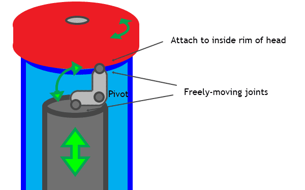

Thank you for the detailed responses and diagrams.
I understand the design up to the point the joint attaches to the inside rim of the red head. I don't get how that would cause rotation. I can think of few ways but none seem a good approach due to complexity so I would love to hear what you had in mind instead.
Thanks again.

Hi, Thanks.
Terribly sorry but I'm not sure I understand this part:
I'll make an illustration for you to verify if I understand your idea.

:slaps forehead:
That's WAY simpler than my contraption. Although:
You transfer movement by torsion. I chose transferring movement by translation because I felt it would transfer the movement more faithfully along the length of the shaft.

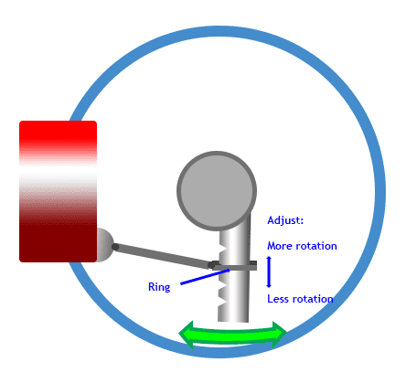

You could have an arm on the axle, or just a gear.
Indeed. The rack and pinion system Tom G thought of will work nicely.
A rotation of 10 degrees, for a pen that is about 8mm in diameter, is less than 1mm.
That's easily within the press range of any store-bought push-button.
Yeah, I considered a gear but rejected that because because keeping them engaged requires there be almost Zero wobble, or play, in the pushbutton.
A variation, perhaps suitable if the product is metal instead of plastic, would be put a spring-pin (dowel-pin) thru the axle to replace the pinion. You can end up with a similar linkage approach used in the popup stopper in a bathroom sink. That linkage implements "Pull up the handle and the stopper moves down to plug the drain."

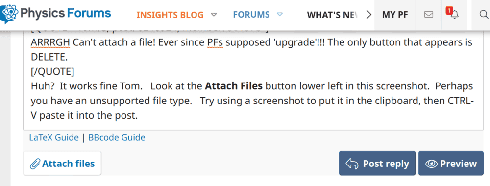

Aww heck, words don't work. Guess I'm forced to draw the darn thing.
EDIT:
ARRRGH Can't attach a file! Ever since PFs supposed 'upgrade'! The only button that appears is DELETE.
Oops, the attachment did show up, at the bottom of this post. It just didn't show in the Preview.
/EDIT:
I'll try some text graphics using [ code=text ].

I'm sorry, the rack and pinion idea makes sense to me but the above I don't understand.
There's a hinge on the object connected to the button as I understand but unless that object stretches or bends it can't rotate the middle axle.
What's the downside with rack and pinion again?
Likes faxibe and Tom.G
The great thing about Tom's solution is that it easily lends itself to fine-tuning after being built.
So, once you have the thing made, you can adjust to your taste how far the rotation of the head is for a button stroke.
Put some notches on the axle's arm and a "ring" around it to engage the notches.
You can slide the ring in and out on the arm, changing the amount of rotation that the main axle rotates with a button press.
Likes faxibe
  • #31
Ah, I see it now.
Thank you for the further clarification DaveC.
I believe two hinge connections are enough and a full ball-socket connections or similar are not needed for this.
That said I believe for my project specifically a rack and pinion is more than good enough for the job.
Thanks everyone who participated in the discussion.
