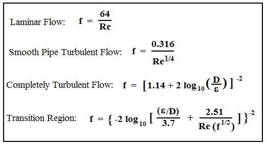

To be clear, I didn't say the Reynolds number for your flow was 700,000, just that for fully turbulent flow inside a 1" pipe, the Reynolds number had to be at least 700,000.
Using a flow rate of 4 GPM and your velocity of 15.4 fps, the actual Reynolds No. for your flow is about 8200, which brings up another issue: the type of flow regime.
In fluid flow, there is laminar flow, fully turbulent flow, and a transition zone between the two. In each flow regime, there is a different formula for calculating the friction factor. The friction factor formulas are listed below:

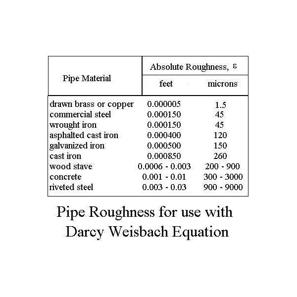

The absolute roughness values for several different pipe materials are given in the table below:
This article discusses the various friction factor formulae in more detail:
http://en.wikipedia.org/wiki/Darcy_friction_factor_formulae
The equation for friction factor calculation in the transition zone is known as the Colebrook equation. In its full glory, the friction factor f can be calculated only by using an iterative process. The article above gives several approximate versions of the Colebrook equation which avoid using iteration to calculate f.
If you are basing your pressure drop calculations on a friction factor which is valid only in the turbulent zone, but you have laminar flow or flow in the transition zone, then your pressure drop calculations will be in error.
The equation you have been using to calculate the friction factor is based on pipe materials which have no roughness whatsoever, i.e., a perfectly smooth material, which typically doesn't exist. The friction factors obtained from such an equation must therefore be considered approximations to the friction factor inside an actual pipe. In any event, this formula is valid only for flows with Re < 100,000.
For pipes which are not smooth, once fully turbulent flow develops, the friction factor becomes a constant, independent of the Reynolds number of the flow.

The absolute roughness ε for commercial steel pipe is 0.00015 feet = 0.0018 in
The relative roughness ε / ID = 0.0018 / 0.93 = 0.0019
Using the Haaland equation to estimate f
1/√f = -1.8 log [(0.0019 / 3.7)1.11 + 6.9 / 12,117]
1/√f = 5.577
f = 0.0322
Plugging this value of f into the Colebrook equation to check:
f = 0.0324
which should be the friction factor to use to calculate pressure drop.
