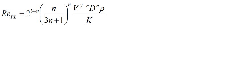

For this problem, I calculated the reynold's number and found that it is turbulent flow. Then I used the attached chart to find the fanning friction factor, which I knew I needed for the head friction for Bernoulli's equation. From there, I can't find the pressure drop using any experimentally derived formulas since those deal with laminar flow. At this point I wasn't sure how to calculate the pressure drop, so I took a peek at the solution.
What they do is use bernoulli's equation (I was doing the same), but the peculiar thing that was done was setting the work per unit mass to zero. I was under the impression that there is a pump, therefore W should not be zero.

I'm interested in the formula that you used for the Re. This looks similar to the Metzner Reed Re, but not quite. I used a similar approach to get the Re (based on the viscosity evaluated at the laminar flow shear rate at the wall), and it came out to be about 22000. I see where most of the factors in your Re come from, but not the first two.
chet
Yes, the crux of my question is the following: How can the shaft work be zero if a pump is present? Isn't a pump doing shaft work?? Do you see the mechanical energy balance, where I set W to zero and equate the change in pressure over density to the friction head? That is what the solution says, but I don't understand how W is zero if there is a pump present.
Below is the equation for the Reynold's number of a power law fluid given to us, since you are interested.
