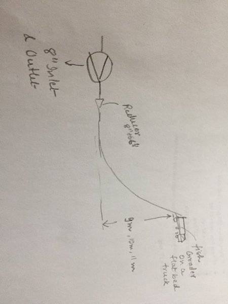

I have a pump running at 400rpm with 8" inlet and outlet with head 30 ft 500 gpm. Now I am planning to reduce the discharge line to 6" . Assuming the flow rate and speed constant the velocity in the pipe will increase. How do I calculate the change in head?

Thanks Russ. I am going to add a sketch here. As you have mentioned that I need to know the pipe length. The flow rate and head I am referring to is from a pump curve with 8" inlet and outlet
. I need to calculate the flow at different heads when using 6" pipe.

Pump generates 36' head max. the point I am looking at 500 gpm at 30 ft head. I need to calculate the change in flow with 6" pipe for 9,10 and 11 m head. It is not the gain. Sorry for confusions.

Ok, that's kind of what I figured. The difficulty here is that there are multiple variables and a real-world pump with a unique performance curve. Since you have one performance point fully spec'd, you can use that to predict the others, but you will need a way to map the calculations to the pump curve. To do that, I'd create a spreadhseet that models the piping system, calculating total system pressure drop from flow rate.
When you model the altered system (with the smaller pipe), you'll get a higher pressure than your pump is actually capable of handling. So then you adjust the flow rate in the new system until you reach a combination of flow and pressure that is back on the pump curve.
One potential problem I see is that since you are close to the maximum head of the pump, you are likely to find that small changes in lift result in huge changes in flow rate. The piping loss is a relatively small factor.

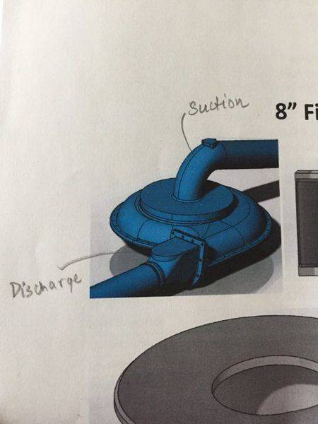

These pumps are single vane impeller pumps used to transfer live fish from one tank to the other. These are not traditional centrifugal pumps. Hence the curves.
Fair enough. Odd curves, but I'll take them for what they are.
