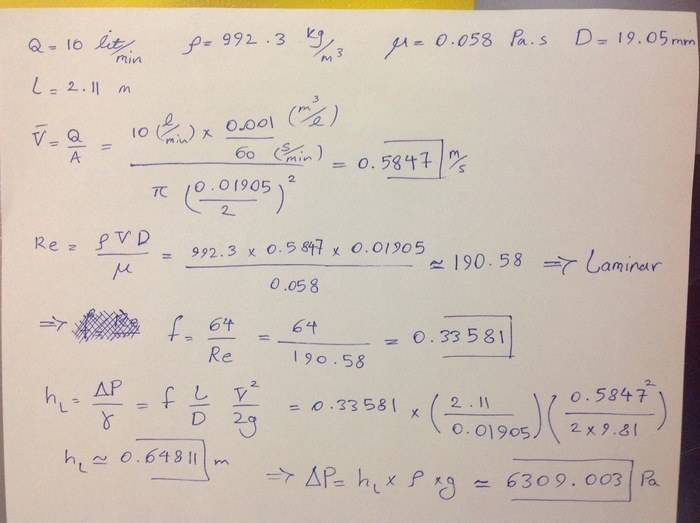

Let's see your hand calculation.
Likes Omish
e1a289f3ad.jpe
What is your source for estimating viscosity? To me it looks like you are off by several orders of magnitude there.
I confirm your hand calculation of the pressure drop. So the error must be in the implementation of the Fluent calculation. It sounds like you did not use the correct tube length. Is that possible? Did you only use half the U?

They are reported in a project of experimental work. I also tried with another case and material which had the viscosity of 0.108 Pa.s
The results were in the same manner. If you mean my viscosity amount is not normal what should be the range of normal viscosity?

Did you check his value for viscosity? Assuming the working fluid is water (based on the density value he used), then his viscosity should be in the ballpark of 0.65×10-3 Pa⋅s, quite a bit lower than what he has used.

What is your working fluid here?

No I checked it several times. The lengths are all correct and the U-piep is modeled completely.
It's hard to imagine that Fluent would get such a calculation incorrect. This would have been their first validation check. Is the fluid non-Newtonian, with shear rate dependence? Is the difference exactly a factor of 2?

Let's keep our eye on the ball. The value of the viscosity is irrelevant to the comparison we are trying to make.

I finally found the problem ! So weird. for straight pipes the answer is wrong also UNLESS you model them as AXISYMMETRIC ! for my geometry (U-shaped pipe) is it possible to model it axisymmetric? if not what can I do now?
