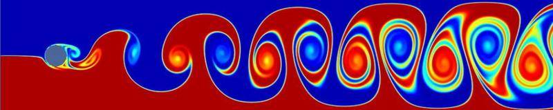

I did a vortex shedding simulation on my pc 2-3 years ago, I solved the incompressible Navies stokes equations with gerris for two mixing fluids, for Re=400. It took a week to finish. This was on an old AMD quad core. I guess on a new i7 this would go at least 10 times faster. Here's a picture:
The picture shows the mixing between the blue and the red fluid. On a modern pc this should not be a big problem for low Reynolds numbers. If you want to simulate turbulent flows, then you need a much finer mesh to resolve all the small scale structures. Still, you could do some 2D turbulent flow simulations on your pc if it's new, fast and you're willing to wait for a couple of days.

Yeah, I was running simulations on a box with I think 6 or 8 processors. I was able to solve the problem I was dealing with in less than an hour with careful refinement. ANSYS Fluent allows you to refine based on gradients (in your case, pressure or velocity gradients). That way areas of the mesh with low gradients stay coarse, and it cuts down the solving time exponentially. If the software you're using has a feature like that, use it! Otherwise, you're looking at a few days to get a grid independent solution (even with a multi-core, multi-threaded processor).
