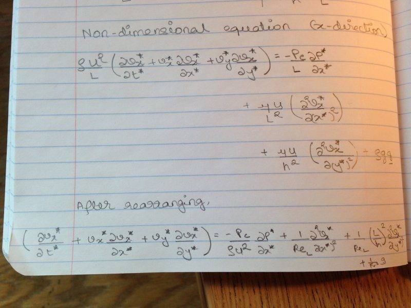

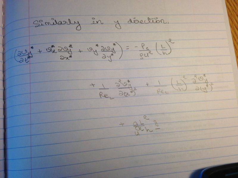

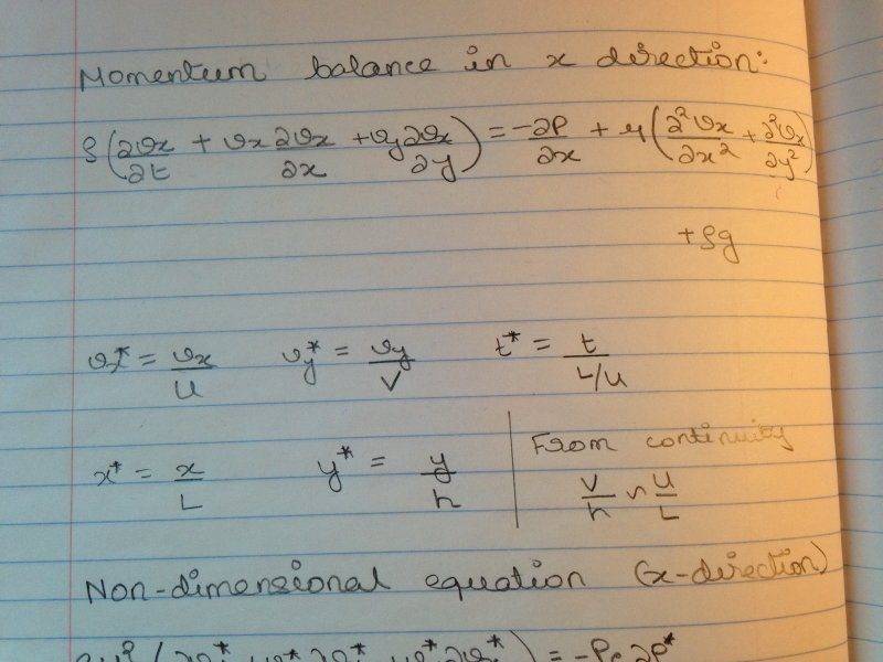

So I have a related question to what we were discussing earlier. I usually don't need to non-dimensionalize the momentum balance in the y-direction, but this one time I did and I realized I was a bit confused. Please take a look at the description of my non-dimensionalization procedure in the attached. It turns out that after proper rearrangement, the non-dimensionalization in the y direction is very similar to the x-direction one (when I rearrange to bring in the Re_L i.e. the Re taking characteristic length in x direction), except with (L/h) everywhere.
Now in the situation L>>h, it looks like the convective term foes away entirely and we're left with the pressure term., the gravity term and the viscous terms. So now without the Re being >>1, we can't eliminate the viscous terms. However in most situations we are only supposed to be left with the pressure and gravitational term so that it is just hydrostatics. My Prof got to that conclusion by not going to the extent of rearranging everything to get the Re_L and just said all terms other than the pressure term and gravity term are multiplied by (h/L)^2 so they're small. However isn't there a way to get to that conclusion from where I ended up?

I'm pretty sure I can help you, but I'm unable to read the attachments you sent. It's just too small on my computer screen, and, unlike ordinary web pages, I'm unable to zoom on the attachment. Any chance you can Latex it?

So unfortunately I've never used Latex before :-( ...would probably be a useful thing to learn. I've taken a different set of pictures, more zoomed in, so pleasetake a look if this is better. If not, I'll try to learn Latex :-)
Thanks a lot!
OK. Here's what I got, assuming y is the vertical direction:
I set ##P_c=ρu^2##. So, for the x direction:
$$\left[\frac{\partial v_x^*}{\partial t^*}+v_x^*\frac{\partial v_x^*}{\partial x^*}+v_y^*\frac{\partial v_x^*}{\partial y^*}\right]=-\frac{\partial p^*}{\partial x^*}+\frac{ηL}{ρuh^2}\left[\left(\frac{h}{L}\right)^2\frac{\partial ^2 v_x^*}{\partial x^{*2}}+\frac{\partial ^2 v_x^*}{\partial y^{*2}}\right]$$
For the y direction, I get:
$$\left(\frac{h}{L}\right)^2\left[\frac{\partial v_y^*}{\partial t^*}+v_x^*\frac{\partial v_y^*}{\partial x^*}+v_y^*\frac{\partial v_y^*}{\partial y^*}\right]=-\frac{\partial p^*}{\partial y^*}+\frac{ηL}{ρuh^2}\left[\left(\frac{h}{L}\right)^4\frac{\partial ^2 v_y^*}{\partial x^{*2}}+\left(\frac{h}{L}\right)^2\frac{\partial ^2 v_y^*}{\partial y^{*2}}\right]+\frac{gh}{u^2}$$
Chet
Yup, that's what I get too,but if you rearrange a little more (y direction), you will get Reynolds number (=rho*u*L/mu) multiplied by (L/h)^2 in the viscous terms...except your rho has gone away. So then how would you prove that the y direction equation boils down to hydrostatics? Currently in your equation, you have (h/L)^2 multiplied into all but the pressure and gravity terms, so they're small...but after the rearrangement to get the Re in there, the situation looks a but different.
Well, for this particular situation, in which the length scale in the y direction is much smaller than the length scale in the x direction, the more appropriate definition of the Reynolds number would be ##Re = \frac{ρuh^2}{ηL}##. So presumably, with this definition, Re would be held finite while h/L becomes small. This would be accomplished with adjustment to u and/or η.
