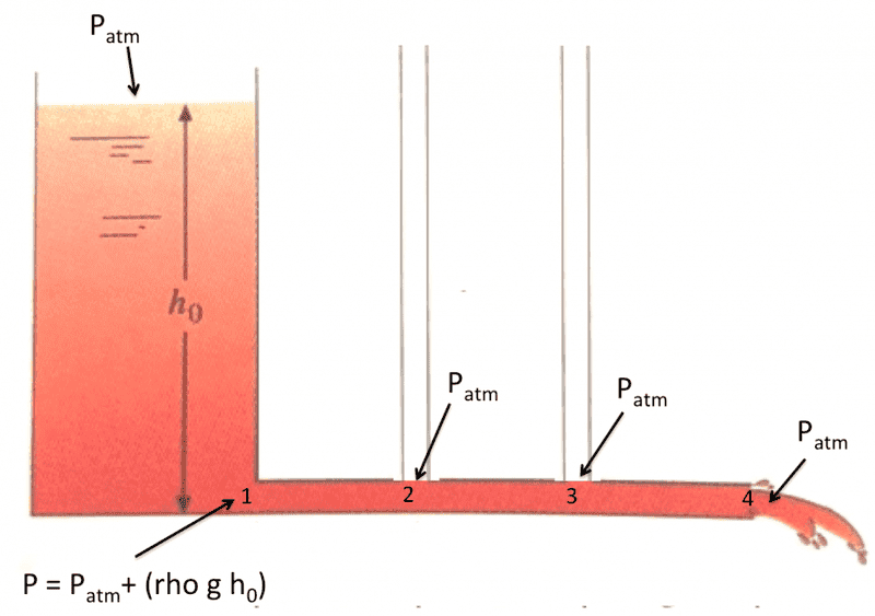

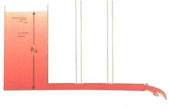

Hello,
I am trying to understand how to apply Bernoulli's equation (which is valid along a single streamline and in the case of zero viscosity) to the situation below.
The ideal fluid moves at constant speed along the horizontal pipe. Because the fluid is ideal (zero viscosity), the ideal fluid will reach zero height inside any of the vertical piezometers. Why? I know there is no pressure drop along the horizontal pipe since the viscosity is zero.
If the viscosity was not zero, the fluid would actually reach a nonzero height along the first piezometer and a lower, nonzero height in the second piezometer (to indicate the pressure drop). How come the viscous fluid would manage to go up the piezometric tubes while the ideal fluid does not?
Thanks.
For an inviscid fluid, the pressure at the exit of the tank is equal to atmospheric pressure, so there is no pressure variation along the horizontal pipe. The pressure at the base of each piezometer is atmospheric, so the fluid cannot rise.
If the fluid is viscous, then there is a pressure drop from the inlet end to the exit end of the horizontal pipe, and the pressure varies linearly from the inlet end to the outlet end. This means that the pressure at the exit of the tank is higher than atmospheric pressure. The pressure has to be higher than atmospheric at the tank exit to overcome the viscous drag in the horizontal pipe.
Likes CivilSigma and bsheikho
Thanks Chestermiller,
So, in the case of an ideal inviscid fluid, we have the following pressures:
The fluid must accelerate between point 1 (pressure higher than atmospheric pressure) and point 2 (atmospheric pressure). After that, the fluid proceeds at constant speed (continuity equation). There must therefore be a pressure gradient from point 1 to point 2. Does the pressure become atmospheric even before point 2 along the pipe?
Why would the pressure at points 2,3,4 be atmospheric and not equal ##(P_{atm}+\rho g h_{0})##, i.e. the same pressure value as in point 1? I understand that on the right side of the exit orifice of the horizontal pipe the water stream is free and is the open atmosphere so the pressure on it is atmospheric. But to the right of the orifice, the pressure should not be atmospheric pressure. Why is it? If we cut the horizontal pipe (i.e. perform the Torricelli experiment), the pressure at the drain is always taken as atmospheric if the drain hole is very small and we are considering a point just outside the hole, in the open atmosphere.
In some textbooks we see an ideal non viscous fluid flowing in a pipe and the piezometers along the pipe have fluid reaching the same height (to indicate no loss in pressure) but those heights are not zero, like in the figure below (point c and d):
What am I missing? I know that Bernoulli's equation needs to be applied to a single streamline, inside an ideal fluid and that the sum of the three heights (geodetic, piezometric and kinetic) must be constant.
In the first figure, the pressure at point 1 is not given by the hydrostatic equation, even for an inviscid fluid. Within the tank, in the region approaching the exit hole, the flow is accelerating toward the hole and the pressure is decreasing. The effective region where this occurs is within a few hole diameters of the exit hole. So the pressure at the exit hole is atmospheric, not hydrostatic.
In the 2nd figure, there are decreases in cross sectional area in the horizontal tube, so, by Bernoulli's equation, the pressures at e and f are higher than atmospheric, and the pressures at b and c are higher than at e and f.

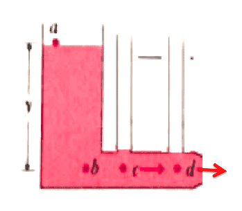

I am re-reading the content of this thread on piezometric measurements and realized that I still have some doubts. Let me explain and hope you can help:
CASE 1: The figure below illustrates what happens in the case of an inviscid (zero viscosity) fluid flowing inside a horizontal constant cross-section pipe connected to the bottom of a container. No fluid would rise inside the two vertical piezometers which implies zero gauge pressure: the pressure at points ##c ## and ##d## inside the fluid is equal to ## P_{atm} ##. I am confident in this result.
The next figure shows instead what would happen if the fluid had nonzero viscosity.
  • What would the gauge pressure ##P_b ##be in that case? Would it be close but smaller than the hydrostatic pressure at that depth?
  • What would the gauge pressure ## P_c## be in that case? What determines its magnitude? Does the distance of point ##c## from point ##b## determine its magnitude?
I believe this third figure below represents an impossible case: the gauge pressure is nonzero and identical in both vertical piezometers and the pipe cross-section is constant. Would that be possible?

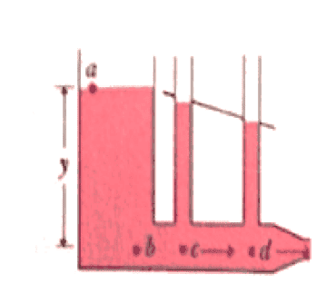

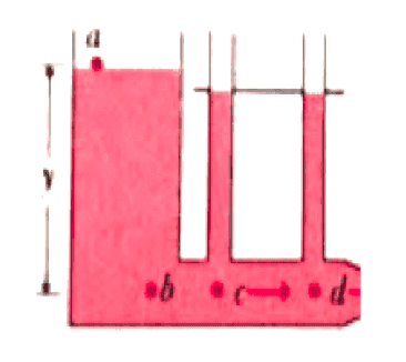

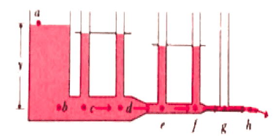

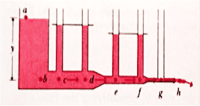

CASE 2: The figure below still deals with an inviscid fluid (I believe) flowing inside a non-constant cross-section pipe. I think the fluid is inviscid because the pressure at point ##c## and ##d## remains the same in the constant cross-section segment: ## P_{c}## = ##P_{d}##. The same goes for ##P_{e}## = ##P_{f}##. However the pressure ##P_{d}## > ##P_{e}## just because of the pipe constriction and not because of a pressure drop due to nonzero viscosity. As mentioned, the liquid is inviscid.
  • So why is the gauge pressure in the piezometers not zero, i.e. ##P_{c}## = ##P_{d}= P_{atm}##, like it happens in case 1 if the fluid is truly inviscid?
  • What physically causes the fluid to rise in the tubes above point ##c## and ##d##?
  • What is the approximate gauge pressure at point ##c##?
Thanks for your help!
Some of the figures for Case 1 show the duct converging just before the exit to the atmosphere, and some show a negligible amount of this. I'm going to assume that they all don't include converging section before the exit.
As the entrance to the lower duct is approached, the pressure at point b is getting closer to the total viscous pressure drop in the entire tube, and less close to hydrostatic.
The gauge pressure at point C would depend on the viscous pressure drop between point C and the tube exit. This depends on many factors including the volumetric rate of flow, tube diameter, fluid density, fluid viscosity, and distance to the exit. Of course, it can't be higher than the hydrostatic pressure in the tank.
The line you have drawn should pass through zero rise at the tube exit. Typically, I would expect the slanted line in the figure to be lower.
It applies neither to viscous flow nor inviscid flow
The fluid has to be accelerated in the converging sections between the constant-diameter sections. This requires a higher upstream pressure than downstream pressure.
The pressures at c and d are above atmospheric, and the pressure at the top of these columns is atmospheric. So, in order for a vertical force balance to exist, a column of liquid has to be present. This is all just hydrostatic.
I think that you personally should be able to work this out using the Bernoulli equation. Let's see your attempt.
Well, I think the pressure ##P_b ~ \rho g y##. Since the efflux speed is ##\sqrt{2 g y}##, Bernoulli equation would give that the pressure at point ##c## is $$P_c= \rho g y - \frac {\rho } {2} (2g y) $$

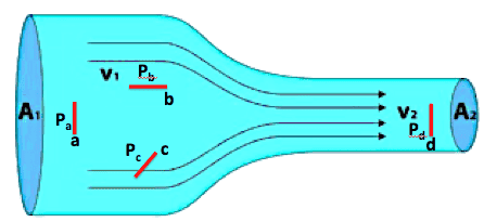

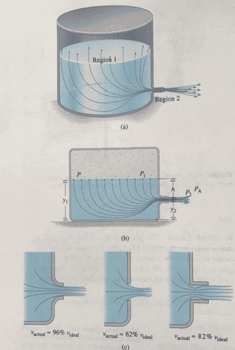

Also, for those interested in this topic (like me), I found these figures showing the impact that the orifice size and shape can have on the ideal efflux speed ##\sqrt{2 g y}##. I wasn't aware of that.
I notice from the figure (a) above that there are multiple streamlines reaching the bottom orifice. We can only apply Bernoulli principle to a single streamline. Does it matter which one we choose?

This is incorrect. Depending on the exact location you specify for point b, the pressure will be somewhere between ##\rho g y## and something somewhat less than this. You can see this from the other figures you have provided, where the streamlines are converging toward the orifice. So, as the streamlines converge, the velocity for the fluid between pairs of streamlines increases (to preserve the volumetric throughput rate). This increase in flow velocity is accompanied by a decrease in pressure. So, in regions where the streamlines are far apart, the pressure will approach ##\rho g y##, but at the orifice, the pressure will be lower. Note that all the pressure variations we are describing here occur within the tank in the region approaching the orifice.
This is incorrect too. If ##A_c## is the cross sectional area at c and ##A_h## is the cross sectional area at h, the velocity at c is related to the velocity at h by: $$v_c=\frac{A_h}{A_c}v_h$$So, applying Bernoulli's equation gives:
$$p_c+\frac{\rho}{2}\left(\frac{A_h}{A_c}\right)^2v_h^2=\frac{\rho}{2}v_h^2$$
or
$$p_c=\rho g y\left[1-\left(\frac{A_h}{A_c}\right)^2\right]$$

  • At the piezometer base, if the fluid is moving at a speed v, would the fluid pressure along the longitudinal direction (where the fluid is moving) be the same as the pressure measured transverse to the direction of flow that pushes the liquid up the piezometer? Based on the isotropy arguments above, it would.
  • When a liquid is at rest, at a certain depth, the average random momentum of the fluid particles determines the pressure at that point. If the fluid was moving, how does the bulk fluid motion affect the pressure (average random fluid particle momentum) in a direction transverse to the bulk fluid motion?
fog37 said:
I see. Thank you.
What you are saying, if I understand it correctly, is that when we stop the moving fluid at a stagnation point, the pressure at that stagnation point is still isotropic (i.e. equal in all directions, like the pressure in a fluid at rest). If we "asked" the fluid particles around that stagnation point what pressure they experience, they would say the same pressure.
Yes, if, by particle, you mean parcel and not molecule.
Apart from capillarity effects (if the diameter is too small), does the piezometer tube diameter matter?
It does not matter as long as it doesn't encompass a lot of axial distance over which the pressure changes.
A piezometer measure the gauge pressure in the fluid right at its base (i.e. at the pipe walls). The vertical height reached by the fluid in the piezometer correlates with the pressure exerted by the fluid at the piezometer base. This liquid pressure at the piezometer base supports the liquid column inside the piezometer. This push (pressure) must be directed perpendicularly to the fluid flow.
The pressure at the base of the tube is the same in all directions. The tube must be oriented perpendicular to the fluid flow.
Yes.
From a frame of reference moving with the moving fluid velocity, the fluid is not moving. Either way, the pressure is isotropic. Repeat after me:
Pressure is isotropic
Thanks Chestermiller. I repeated "Pressure is isotropic" 40 times and I think I am getting it : )
Also, am I correct in thinking that:
at a hypothetical point A inside a fluid a certain depth ##d##, the pressure is always isotropic. That pressure ##P## is larger if the fluid is at rest and smaller if the fluid is moving at speed ##v##. The larger the speed ##v## the smaller that isotropic pressure will be.
Bernoulli's equation could be written this way: $$P= (constant)- \rho g d - \frac {1}{2} \rho v^2$$
which indicates that the larger ##v## the smaller ##P##.
But we know that and the larger ##d## the higher ##P##. The equation above instead shows that ##P## would decrease with depth ##d##. That is clearly wrong...
Thanks!
fog32
You're trying to compare apples and oranges. For the same steady state flow, the pressure is smaller in higher speed regions than lower speed regions.
Thanks!
fog32
In the Bernoulli equation, the d in your equation should be elevation, not depth.
Ok. I see how, for the same steady state flow, the pressure is smaller in higher speed regions than lower speed regions. but if the flow was stopped, the pressure at those same point under examination in the fluid would be higher, I believe...
As far as ##d## being depth or elevation, when ##v=0##, doesn't bernoulli's equation become the equation for hydrostatic pressure $$p = \rho g d$$ where ##d## is the depth in the liquid?
If part of the flow is stopped, such as the tip of a pitot tube, then the pressure is higher there. But, if the entire flow is stopped, then the fluid is not moving at all at steady state, and you have a hydrostatic system.
Yes. That's why your equation in post #26 is wrong. It should read:
$$P+\rho g z = const.$$where z is measured upward (not downward).
1) I see how a fluid at rest and a fluid in steady motion are different situations. I guess I am wondering if the isotropic pressure, at the same spatial point in the liquid, would be higher if the fluid was at rest (not a stagnation point). How different would the pressure experienced by the liquid parcels be?
2) Ok, but if you take the equation in your post #29 (where ##v=0##, which implies a fluid at reset) and move the term ##\rho g z## on the righthand side, we get the equation $$P=const. - \rho g z$$, which is what I have in my post #26 (different from the correct expression for hydrostatic pressure)...
  • #31
Do you have a specific physical problem in mind that we can focus on (involving actual equipment and hardware)?
That's not what you have in post #26. You have an h instead of a z. h is measured downwards and z is measured upwards. Do you not see the difference? If the datum for both elevation and depth is taken at the upper (free) surface of the fluid, then ##h=-z## and ##p=-\rho g z = \rho g h##
