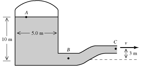

A pressurized cylindrical tank, 5m in diameter, contains water which emerges from the pipe at point C with a velocity of 25 m/s. Point A is 10m above point B and point C is 3m above point B. The area of the pipe at point B is 0.07 m2 and the pipe narrows to an area of 0.02m2 at Point C. Assume the water is an ideal fluid in laminar flow. The density of water 1000kg/m3

Except PC and PBis unknown so this approach shouldn't work. One of my peers claims it is the same as 1 ATM but I'm doubtful since this does not result in answer which is accurate. I don't see how The pressure at Point C could possibly be 1atm... 2 unknowns .. 1 equation.. not going to work :( correct me if wrong.

What are you trying to find? Pressure at B? Or Pressure at A? You don't need to consider what's going on at point B to do that.
Presumably the pipe vents to atmosphere, so point C must be at atmospheric pressure.

That is just bernoulli's equation, you were actually very close to reaching that arrangement :
AnotherParadox said:
PB = PC + (1/2)DVC2+DghC -(1/2)DVB2-DghB
Use gauge pressure as your datum so PC = 0, and let your height datum be at point B so hB = 0. Plug all those in and collect like terms and you'll reach the solution you quoted, note that the answer is still guage, not absolute pressure.

Changed it to 0 and bam same kPa in for gauge pressure. Thanks a ton you have no idea how many countless hours I spent on this damn problem.
