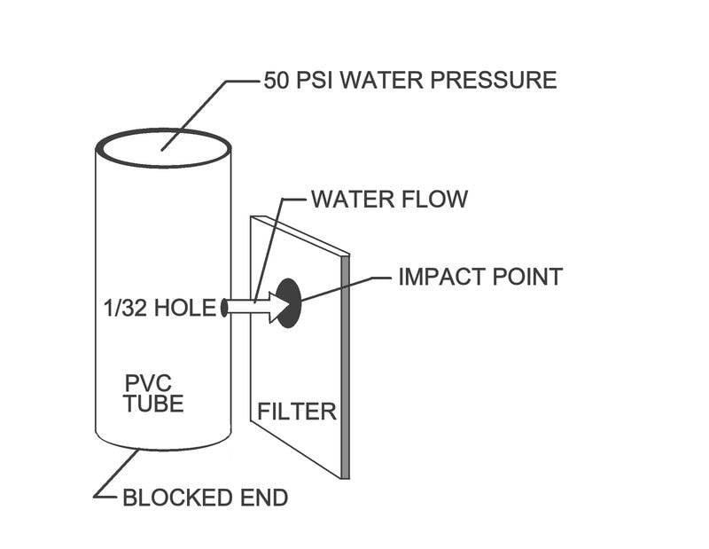

Is this the situation?

Is this the situation?View attachment 302230
Yes that is pretty much it but with 10 holes but even calculating with 1 hole would be very helpful

As we have said, the pressure is zero at the exit. It just is. So, this idea that you can get "150 psi exit the hole" just isn't a thing. But as @Baluncore implied, when this atmospheric pressure jet hits the filter it will apply a force, over a small area, which is like applying a pressure. And you can solve for the flow rate/velocity and force/pressure at the impact if we specify the conditions. So let's use the 50 psi in the manifold and 1/32" hole per the diagram from @AZFIREBALL -- and yes, there's no real difference in calculating for one hole than for 10 (just multiply by 10 after). We can ignore the head loss in the rest of the piping system because we'll assume the velocity will be kept low (generously sized piping) - it'll get us close as a starting point. Yes, you can use Bernoulli's equation to calculate the exit velocity...
