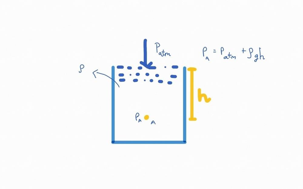

Question 1
Consider a sample at a height ##โ„Ž## below the interface of air and the fluid. The pressure on the sample is given by ##๐‘ƒ_๐‘Ž=๐‘ƒ_{๐‘Ž๐‘ก๐‘š}+๐œŒ๐‘”โ„Ž##.
My question is does ๐‘ƒ๐‘Ž include the pressure due to the particles that are to the side of the sample?

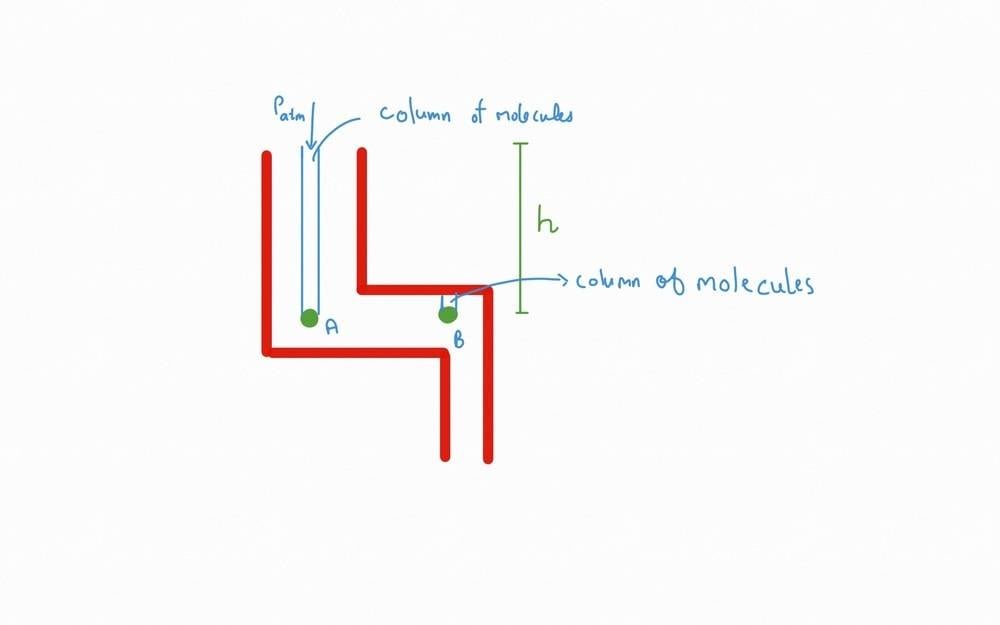

Now consider this setup.
In this setup the two samples, say ##A## and ##B##, must experience same pressure i.e. ##P_a = P_b ## due to Pascals law. But the column of molecules above the sample is different. Isn't? Above B there are less number of molecules. On the other hand, above A there are more number of molecules and also ##P_{Atm}## adds to it. Due to this, the ##P_a > ๐‘ƒ_b##. But this isn't the case. When I asked this question to my teacher, he said that around the sample ##B## there are particles to the left that also exert pressure on it due to which ## P_a = P_b##
If this it true, then doesn't particles to the side of Sample ##A## also exert pressure on ##A##?
I asked the first question because of the second question.
Do you think that the pressure exerted downward by the horizontal pipe section above B is atmospheric pressure?
No.
My understanding of pressure as of now is that as we go deeper into the ocean the column of water molecules vertically above that point increases. Hence, weight of those water molecules together is more than that of a point near the sea level. Hence, pressure at a point deeper will be more.

Good. So now you understand why the pressure at B is the same as at A, right?
No I still didn't get it. Is ##P_{wall}=P_{atm}##? If yes, then the pressure exerted by the column of water molecules on B is less. So as ##P_{Acolumn}## (column of water molecules above A) >##P_{Bcolumn}##(column of water molecules above B). Isn't? So this again bring a pressure difference between these two samples.
No. The pressure at the wall above B is not atmospheric. According to Pascal's law, pressure is transmitted horizontally. That means that the pressure at B is the same as at A. Otherwise, fluid would be flowing from A to B. So the pressure at the wall above B is $$p_w=P_B-\rho g \delta=P_A-\rho g \delta=p_{atm}+\rho g (h-\delta)$$where ##\delta## is the vertical distance between point B and the wall above.

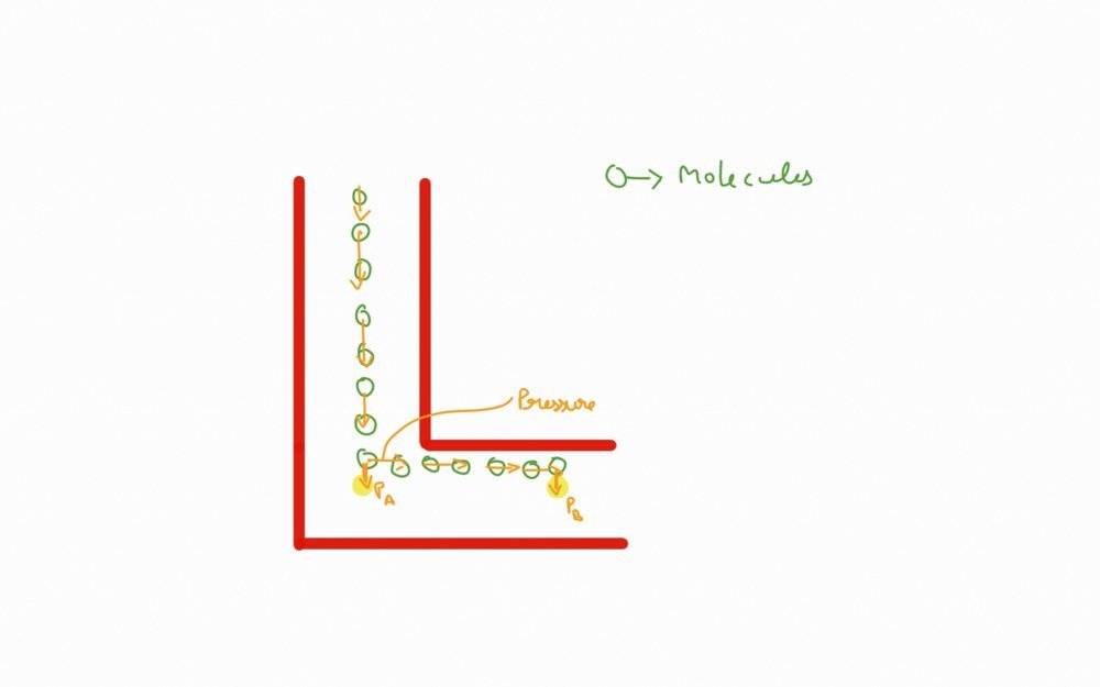

Please excuse me, but my question is how does it affect B? I understand that you mean the molecules above A is above B. But how does it exert pressure on B? I am not able to visualize it.
Thanks!
PS - Is the representation in the figure right? or Can you show how it affects B in the given diagram?

I don't understand what the arrows in the figure represent.
The arrow shows how the pressure is transmitted.
Then the figure is not correct. Pressure is not transmitted by arrows.

Let us back up a bit and try to explain the self-explanatory.
Consider a small cube-shaped volume of water whose top is at depth ##h## below the surface. What the the pressure on its top surface?
For convenience, let us use "##l##" for the length of the sides, "##a##" for the area of the faces and "##v##" to denote its volume. The density of the water is ##\rho## and the acceleration of gravity is ##g##.
The top surface supports a vertical column of water that extends up to the surface. The volume of that column is given by ##ah##. Its weight is given by ##\rho g a h##. The pressure on the top surface is force divided by area: ##\frac{\rho g a h}{a}= \rho g h##
Which is exactly as expected, of course.What is the pressure on the bottom surface of the cube? We can skip the formulas. The same reasoning applies. The pressure on the bottom surface is just a little higher than the pressure on the top surface because the bottom surface is just a little deeper.
No surprises there.What is the pressure on the sides of the cube?
If that pressure were zero, what would you expect to happen to the water in the cube? It would get squished out the sides. But when the water is at equilibrium, that is not happening. So if the water is at equilibrium (not flowing, not sloshing, not accelerating), what must the pressure on the sides be?
It must be equal to the pressure on the top surface so that the fluid doesn't flow?
