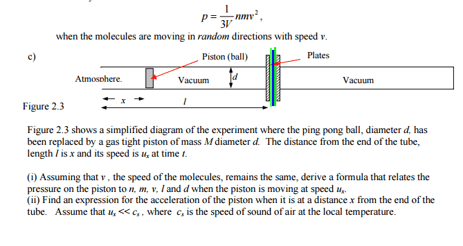

I do not have the answer to this problem. Its not for homework so i won't be getting it either. I don't think my solution is correct though
Let us consider a particle with speed V(x) perpendicular to the piston.
As it collides with the piston we conserve both momentum and energy
mV(x)+MU(x)=mV(1)+MU(1)
V(x)-U(x)=U(1)-V(1)
solving for V(1) we get V(1)= 2U(x)-V(x) in the approximation M>>m.
then I'm not sure whether i should assume V(x)>>U(x) and simplify this further to V(1)=-V(x) but i did use this for further calculations.
So the change in momentum of that particle is -2mV(x)
Now we calculate the average time a particle will take to collide with the piston as the average distance of particles from the piston divided by V(x) = x/2*(V(x))
the average force on the piston is thus 4m(V(x))^2/x
the average pressure is thus 16mn(V(x))^2/(x*pi*d^2)
since the particle can be moving in any direction we get V(x)^2=V^2/3
and then we replace that back in the above.
Now the next part i just use F=Ma and obtain an expression. However this seems very simplistic for an olympiad level problem so I'm not sure about this

I should have posted the full question. This is basically a model for the propulsion for a pingpong ball in a vacumm tube.
Okay, maybe u are right since the question does not define what n is exactly. Yep i can get an expression for the pressure from there.
Okay but now if that's the pressure i' not sure how to get the acceleration as a function of x

this is weird as the previous part of the question is literally about the standard derivation of P=nmv^2/3V
It would be interesting to see the full question. This is part (c), what was the reference to a ping pong ball?
here is the question http://www.physics.ox.ac.uk/olympiad/Downloads/PastPapers/BPhO_Paper3_2005_QP.pdf is question 2.

It would be if you could include the density of the air in the equation, but you are told to use n, the number of molecules in some volume, and the mass m of each molecule, and the diameter of the tube. The only way for you to express the density is by specifying the volume for n, and to do that you need to mention x.
