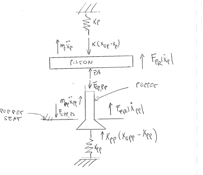

here a cross sectional picture of the regulatore I'm trying to model:
Can you describe your model so far? Things like the mass of the moving parts (poppet, stem, diaphragm backing plate, spring, etc...), flow restrictions through the valve (give consideration to how far open the valve actually is at anyone point in time), how upstream and downstream pressure reacts to the opening of the valve, etc...
Yes, I can describe the model and I'm developing a simscape model to reproduce the dynamic of the pressure regulator. Here a sketch with the forces of the moving parts:
Xop, xopp: free length of the poppet and piston spring
Xp, xpp: piston and poppet displacement
Fcp,pp: contact force between the poppet and the piston
Fcps,pp: contact force between the poppet and the poppet seat
kp, kp: stiffness of the piston and poppet spring
Fr: friction force
mp, mpp: mass of the piston and the popet

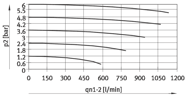

I'm trying to reproduce the pressure - flow rate curve of the pressure regulator I see in the datasheet and its step response. Here the pressure - flow rate curve I'm trying to fit:
I'm using an optimization solver to find the parameters that minimizes the SSE between the datasheet curves and the ones of the model. Moreover I have added non linear constraints to comply the valve step response specifications (i.e. rise and settling time and peak overshoot).
In order to get a similar dynamic behaviour of the pressure regulator with any set of paramaters, I have parametrized the spring stiffness in function of the valve max displacement (i.e. valve cross area) and the pressure differential between the outlet and the setpoint. In this way the valve is completely open with a specific pressure differential. This worked very well with a valve with the following kind of pressure - flow rate curve, because the max flow rate doesn't change with outlet pressure
But for the valve before mentioned graph the situation is different, higher pressure, higher flow rate, so I believe the area changes with pressure, but I didn't understand how to do it in my model. This is another open issue of my model. Maybe the spring parametrization is wrong?

The only mode of oscillation I can see in your poppet valve model is the delay in piston movement to counter the valve when it approaches closure. By changing the poppet valve for a spool valve the positive feedback chatter should be eliminated. Attached is an edit of your diagram.

Hi serbring. Those graphs you posted show how a regulator responds to changes in flow rate given a fixed pressure setting on the regulator. For example, the regulator might be set at 1.2 bar at zero flow (ie: "lockup") and as the demand for flow increases, the pressure on the regulator outlet decreases as can be seen in the first graph.
The reason the outlet pressure on the regulator drops with an increase in flow isn't really a "dynamic" issue. The poppet in the regulator isn't changing position when that happens, it is in one position and it stays there while the system flows at the given flow rate. So when flow increases to 450 l/min, the pressure on the regulator has dropped to roughly 0.9 bar as shown on the graph. Note that I wouldn't trust the second graph you provided. It doesn't look like any actual data or any theoretical model of the regulator was taken into account on that one to be honest. A real graph of pressure versus flow for a regulator looks like the first graph you provided with a gradual drop off of pressure as flow increases. So I'll ignore the second graph for this discussion.
The diagram you provided is ok, though I didn't try to look at it in detail. I do see a few problems though. First, as mentioned before, the graph is looking at a valve without movement of the poppet or diaphragm. So there's no need to consider time rate dependant forces on the regulator. You also can neglect frictional forces if you'd like since those are generally small compared to the spring and pressure forces. If you're trying to model that graph you provide, you want to look at a static force diagram of the regulator with pressure causing a force on the poppet and diaphragm and spring forces causing forces where they exist.
Next, you will need to model the flow somehow. The valve poppet has some balance of forces when the valve is closed and pressure is at the set pressure of the regulator. At that point, the spring is providing a force exactly equal to the pressure forces when the poppet is closed. In reality, there's a problem with this simplistic model and that is that the seat needs to have a high enough contact force to seal the fluid, so the spring load is actually lower than the pressure forces at that point since you need some additional force to create the seal but for simplicity, I'll neglect that. We can come back to it later if you want.
The valve is closed at a given set pressure so we'll assume flow is zero at that point. That point on the graph shown above for example might be 1.2 bar with 0 flow (l/min). That's the point where forces are balanced and the poppet is touching the seat. Now the valve opens as pressure downstream where it is being sensed, drops. As pressure drops, the force on the diaphragm and poppet drop to a new, lower value. Since that force is lower, the spring will push the poppet open and come to equilibrium at a new location. When the spring extends like this, the force goes down according to the spring rate times the change in length of the spring, so the spring also has a lower force which must equal the lower pressure force. That's the point you need to determine for a given 'flow rate'. Actually what you need to determine is how far the poppet opens at that point and what the corresponding flow coefficient will be. It obviously won't be "full open" since that won't happen till the pressure decays enough to fully extend the spring and push the poppet to that point. So the full open point can be determined by determining the location of the poppet, the spring load at that point and the corresponding pressure load that puts the entire assembly into static equilibrium. That pressure will necessarily be lower than the set pressure which is why the curves on the graph drop as flow rate increases.
I'll model the pressure force on the valve. Thanks!

I got it, but if there will be 0.4bar of pressure differential between the outlet pressure and the setpoint, the spool displacement is 1mm (consequently a specific cross valve area) independently of the outlet pressure , right?
with my model I'm able to fit that chart, using the before mentioned spring parametrization: with 0.1bar of pressure differential between the outlet pressure and the setpoint the valve is completely open and it doesn't seem to happen to the valve of the following chart.

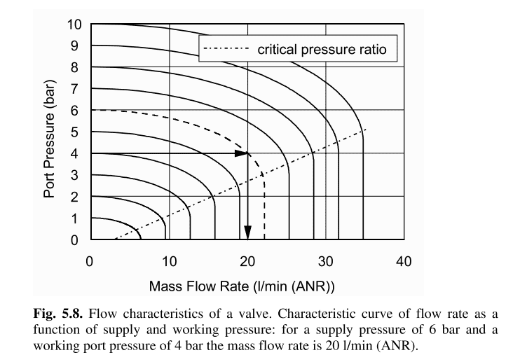

After a meditation, I'm wondering how would it be the GRAPH 1 if for each pressure level the regulator would be test to a 0 bar? Would it be something like that?
[GRAPH 2]
As far as I have understood in a chocked condition the valve flow rate is not dependent by the outlet pressure but only by the inlet pressure, the sonic conductance, the cross area and so on. So I would believe all the lines will drop to the same flow rate. In the GRAPH 1 all the lines don't look to drop at the same flow rate, right? So could it be possible that for the GRAPH 1 the inlet pressure at 6 bar test is different than the one at 10 bar test?
The piston/diaphram dynamic is modeled, look at the rough sketch, xp is the piston displacement.

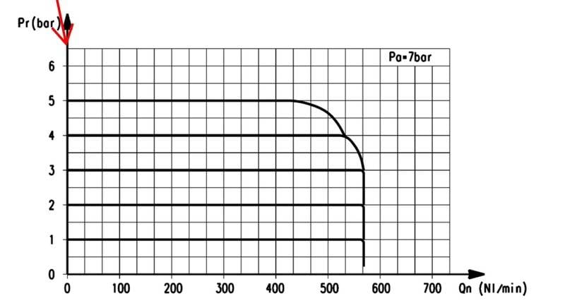

I'm trying to follow your suggestions: I modeled the flow force to the model in a easy way and the pressure fluctuation is lower than in the previous model.
Then I tried to identify the pressure regulator parameters to fit a reference pressure - flow rate cuve. I performed the identification with the an optimization solver and using the SSE as cost function.
The flow rate for all the curves are computed with an inlet pressure of 7 bar and using a ramp and a pressure source I change the outlet pressure during the simulation. The setpoint is constant during the simulation and it is set to the intial outlet pressure, so for the red curve, the setpoint is 6 bar and the outlet pressure changes linearly from 6 to 5 bar. Here you can see a sketch of my model:
Here the reference curve for the flow from 1 to 2:
Here the one of my model:
I can explain the curve of my model: I see the lookup, the drop and the choked flow condition. In my model the flow rate in the choked condition doesn't change with the outlet pressure, instead for the reference curves it looks to change and I can't understand the reason of it. Is the valve Cd (Discharge coefficient) pressure dependent? Does the valve open more at higher pressure than in lower ones? In this case why? Could it be the case the reference curve are created with different inlet pressure? Any suggestion is appreciated

Hi serbring. I can't tell for sure what you're doing in your model, but the output graphs look reasonable. First, let's talk about "flow force". I'm not sure what you mean by that but I assume you're referring to the force exerted on the poppet due to the change in momentum of the gas as it impinges on the poppet as opposed to the force produced by the difference in pressure across the poppet. The former is small and can generally be neglected. The latter is significant for an unbalanced regulator such as the type you show in the picture. A balanced regulator has a poppet that has the same pressure on both ends so that the forces on the poppet during operation are the same and can be neglected.
You should have a calculation that shows shows how the forces are balanced in a static condition. That force balance calculation determines the poppet lift. The poppet lift gives you curtain area which is the cylindrical area around the opening of the poppet. That curtain area is the circumference times the height. That area is your flow restriction which, when multiplied by your discharge coefficient, gives you the valve's flow capacity. The flow is then calculated per that link you provided here:

Note that the link you provided also gives the equation for the critical pressure ratio which tells you if the flow across your poppet is choked or not. If flow is choked AND if the valve poppet has come full open, the line on those graphs goes verticle which you can see on some of the graphs above. On those graphs that don't show a verticle section of line, the valve poppet hasn't gotten to the 'full open' position yet, so a drop in the downstream pressure allows the poppet to open more, increasing CdA and increasing flow. It's only once your poppet has reached it's maximum lift (max open) that you no longer get any increase in flow by decreasing downstream pressure. That statement assumes of course, that flow is choked at the poppet curtain area.
Regarding discharge coefficient, the discharge coefficient can certainly change as the valve poppet changes position and even as the pressures change. The discharge coefficient in this case is like a 'catch all' for various things that can affect the flow. Note that normally discharge coefficient for an orifice has a more specific meaning regarding the vena contracta. It means the same here but the flow geometry is obviously a bit more complex.

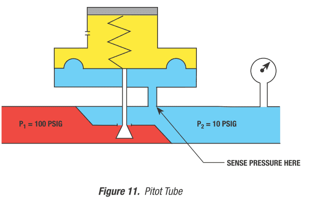

Hi serbring. I went through your post and I’m a bit confused. Equation 1 looks fine. I see you’re using forces downward as being positive and forces up as being negative. I’m not sure if you’re using angles properly, I wouldn’t worry too much about it though. I assume you’ve just rearranged equation 1 to get equation 2 so that’s fine. But I’m not sure about equation 3. Why do you want to take a derivative like that? I see no need to do that and I’m not sure what that even physically represents.
Let’s look at a simplified model for a second, then you can go back to adjusting it for valve poppet angles and so on. For a balanced poppet, we can neglect pressure forces on the poppet and let’s also neglect the second spring you show that’s under the poppet. You can add those in later. That leaves you with force down from the spring is equal to force up due to pressure on the diaphragm. Now let’s consider a simple example using the following values for our regulator:
Diaphragm area = 10 square inches
Spring rate = 1000 pounds per inch
Set pressure = 100 psig
For this regulator, the force up due to pressure is just the diaphragm area times the pressure: 10 square inches * 100 psi = 1000 pounds.
To have the regulator ‘set’ at this point, we need the valve to just come closed at 100 psi, so the spring is almost able to push the poppet off the seat but not quite. So the spring has to push down with a force of 1000 pounds which means that it has to be compressed by x = F/k. So the spring is being compressed 1 inch.
If we took all the pressure off of the regulator and if the spring could actually move the poppet at that point, the poppet would open 1 inch. However, if pressure dropped to only 90 psig, you have a force upwards of 90 psi times the diaphragm area of 10 square inches or 900 pounds. Looking at the spring again, the spring is only compressed 0.9 inches. So with a discharge pressure of 90 psig this particular regulator has a poppet that’s open exactly 0.1 inches.
Once you know how far the poppet is open, you can calculate flow. Let’s say our poppet diameter is 1” and at a set pressure of 100 psi, it has a 0.1” opening when outlet pressure drops to 90 psi. The flow restriction through this valve is given by the curtain area which is the circumference times the height. So that’s 1” * .1” * pie = 0.314 square inches. That opening may have a discharge coefficient of 0.7, but that will be a function of the valve’s geometry and is generally only derived experimentally. From my experience, it generally is in the range of 0.6 to 0.8. Now if you have some inlet pressure you can calculate the flow rate by going to that web page you pointed to before. You have upstream pressure, downstream pressure and your CdA (discharge coefficient times area which is your flow restriction).
The graph you posted has numerous lines. Each line is a set point for that regulator. The lowest line shows a set point of 1.2 bar. Wherever you got this graph from, it should tell you what it assumes for an upstream pressure. The graph doesn’t say, but that is implied somewhere, wherever you got the graph. If you did an analysis on the regulator that you got the graph from, you should be able to sum the forces as shown above, determine how far open the valve poppet is at any given discharge pressure, determine the corresponding flow restriction, and from the pressures on the inlet and outlet of your regulator, you should be able to calculate the flow and come up with the graph.
Note that as long as your regulator poppet continues to open (and presumably the flow restriction goes down, which is a function of geometry) the flow rate should go up, regardless of whether or not it is choked. Because as the poppet opens, you get a larger flow area (curtain area). Once the poppet is fully opened and the flow restriction stops changing with downstream pressure, and assuming the valve is choked, lowering the downstream pressure isn’t going to change anything.
Hope that helps.

Hi serbring,
I’m trying to determine what your notation is. You posted some earlier:
[itex]A_{s0}[/itex]: area where the inlet pressure acts when the poppet is fully closed
[itex]A_{o0}[/itex]: area where the outlet pressure acts when the poppet is fully closed
[itex]A_p[/itex]: poppet opening area
[itex]A_d[/itex]: area of the lower side of the poppet
[itex]A_s=A_{s0}+A_p cos(\theta)[/itex]: relation between the area where the inlet pressure acts and the poppet opening area
[itex]A_o=A_{o0}-A_p cos(\theta)[/itex]: relation between the area where the outlet pressure acts and the poppet opening area
[itex] \theta [/itex]: poppet conical angle
[itex] A[/itex]: piston area
[itex] x_{p}, x_{pp} [/itex]: piston and poppet displacement
[itex] x_{op}, x_{opp} [/itex]: piston and poppet spring free length
Hi Q_Goest,
Thanks for your helpful reply.
I'm sorry, I changed the subscript for the outlet pressure, let's use [itex] P_o [/itex] for it. There was a mistake in the symbol list, I corrected it as you can see in the bolded text in quote. Here a valve sketch that hopefully will help you to understand my notation:
The dotted lines represent the poppet when it's open.
Then you have what seems like a problem equation:
[1] [itex] k_p (x_{op}-x_p)- P_{o} A=0[/itex]
Which is your force balance for a simple regulator. It says the spring rate times the quantity: free length of the spring minus the piston displacement, minus the pressure Po times the ‘piston area’ (assume that is your diaphragm effective area for a diaphragm type regulator or the piston area for a piston style regulator) and that all equals zero for static balance. You don’t say what Po is but I assume that is your actual outlet pressure which I assume is supposed to be equal to or less than the set pressure.
But look at the spring force in that equation... Spring force is supposed to be spring rate times how much the spring is compressed. That’s not what you have in the equation. For that spring displacement part of your equation, you need to show how much this spring is compressed. So the amount of compression in your spring (dx) is the free length minus the compressed length, right? The length of the spring after you’ve compressed it has to be subtracted from the free length to give you how much the spring has been compressed which is dx. Then multiply by spring constant to get your force.
Then you say:
[itex]k_p*x_{op}=P_{set}A[/itex]
Which is spring rate of the piston spring times the free length of the spring which has to equal the set pressure times the area. But spring rate times free length gives you a force equal to the force of compressing the spring so that it is absolutely flat and has no height at all.
I say:
Because when: [itex]P_{set}=P_o [/itex], the valve must be closed, so [itex] x_p=0 [/itex]. Under this assumption my model regulates properly the outlet pressure.
Now let’s go back to one of your questions. You asked:
Let’s talk about a pressure balanced regulator first since that’s a bit easier to understand and you can always modify your equations later to add in additional forces due to pressure and spring loads on the poppet. Equation 1 above should reduce to something like k dx = PA where dx is how much the spring has been compressed (free length minus compressed length). So for some change in pressure (dP) the only thing we have in that equation to make it balance is dx, so dP is linearly proportional to dx. Do you agree? If so, then for any absolute change in pressure, dP, the regulator poppet has to react by changing displacement, dx and those terms are linearly related.
I completely agree with it.
Poppet displacement therefore is only dependent on the pressure differential between the outlet pressure and the set point. For the graph in question, point A and point B both show a difference in pressure differential between the outlet pressure and the set point of 0.2 bar, so the valve poppet has opened the same amount in both cases.
Why the valve flow rate is higher for point A then point B? I can't explain it.
NOTE: The graph doesn’t tell you if the springs used in the regulator are the same or not and it doesn’t tell you what the upstream pressure is. Generally, regulator manufacturers will have numerous different springs for their regulators to handle different outlet pressure ranges because they try to optimize the valve for the pressure range the valve will be operating in. So we can’t say for sure that the amount of poppet opening for those two cases are necessarily the same, but if the same spring was used for each case, then the poppet opening is also the same.
The curves are for a specific valve range (0-2 bar) so I would believe that is the spring rate is the same for all curves. Regarding the downstream pressure, I have few dobts about it, but I talked with the sales man and he said (in not confidently way) that it is the same. In fact in another page of the catalogue I have found the flow rate - pressure chart for the same valve but with a different nominal diameter there is this :
The choked condition is the same so I would believe the upstream pressure is the same for all curves.

Hi serpring,
serbring said:
I say:
So are you saying that [itex]x_{op}[/itex] is equal to the amount the spring is compressed? For example, if a spring has a free length of 2 inches and it’s compressed half an inch then it’s 1.5 inches long at Pset but [itex]x_{op}[/itex] is equal to half an inch. Would you agree?
I just noticed that the graph you are referring to is for an electronic regulator built by http://ftp.festo.com/public/PNEUMATIC/SOFTWARE_SERVICE/PDF_Catalogue/PDF/US/VPPM-G_ENUS.PDF. It is not a conventional, spring loaded regulator such as the ones we’ve been talking about. There are various ways to produce the force needed to open the valve. One way is to use a spring. Another very common way is to use the pressurized gas upstream of the regulator. There are various ways of using this gas. One way is to “dome load” a regulator using a conventional spring loaded regulator. Using this method, you have a simple, spring loaded regulator (preferably a 'self relieving' type) that puts gas pressure above the diaphragm or piston. That pressure pushes down just like a spring but because the volume of gas is generally fairly large compared to the displacement, a regulator loaded this way can more accurately control the outlet pressure. Basically, the equivalent spring rate of the gas is low compared to a spring.

You're on right. I haven't understood that much the technical drawing you can see in one of my previous posts, but as far as I have understood the diaphrams is pushed down by a solenoid, right? So somehow the pushing force is related to a voltage, right?
So under this light the valve areas for the points A and B are still the same? Moreover I don't understand why the max flow rate for the line starting from 2bar (point C) is higher than the line starting from 1.2 bar (point D).

Hi serbring,
serbring said:
I assume [itex]x_{op}= 2[/itex], because the spring is compressed when [itex]P_o > P_{set}[/itex] and it is extended when [itex]P_o < P_{set}[/itex]. It's not probably true because this means to change the spring anytime the setpoint is changed. I was looking for a quick way to model it. Is there any better way of modeling it?
It sounds like you are having some trouble with modeling the spring force. The force exerted by a spring is equal to the spring constant times the amount of compression. F = k dx. So for a spring load of 100 lb/in for example, for every inch the spring is compressed, the force increases by 100 lb. So compress 1 inch, the force is 100 lb. Compress 2 inches, the force is 200 lb. Etcetera.

Q_Goest said:
Hi serbring,
Hi Q_Goest,
You're on right, infact for me the spring force is [itex] k_p (x_{op}- x_p ) [/itex] but in my model the [itex]x_{op}[/itex] is calibrated with the setpoint. Isn't it fine?

Just another doubt regarding the valve curves. I was just reading the specification of the valve Festo vppe, that it has a much simpler layout because it doesn't have any electronic control. The flow rate - pressure curves are quite similar to the ones of VPPM, here the curve:
The flow rate is not linear with the pressure differential (the read line links al the point with the same pressure differential between the outlet pressure and the setpoint for each curve), so I'm wondering: can it be due to the pilot?
Thanks
cheers
Hi serbring,
The regulator's flow rate is a function not only of how far open the poppet is, but also of the upstream and downstream pressures. We can't telll from the graphs, and Festo doesn't tell you, what the upstream pressure is for each of those curves. If the upstream pressure is the same for every curve, I would expect the lower set pressure curves to be out farther to the right than the higher set pressure curves. But that's not the case. It's just the opposite. However, if the upstream pressure is always some small dP above the outlet set pressure, say 1 bar for example, we would expect the curves to look as they do with the higher set pressure curves further out to the right. If you want to understand why that is true, do a calculation on flow through a valve at a fixed Cv and a fixed dP and vary the inlet pressure. You should find that as you increase inlet pressure, flow rate gradually increases. This will give you the red line in your graph that gradually drifts to the right as you increase pressure.
