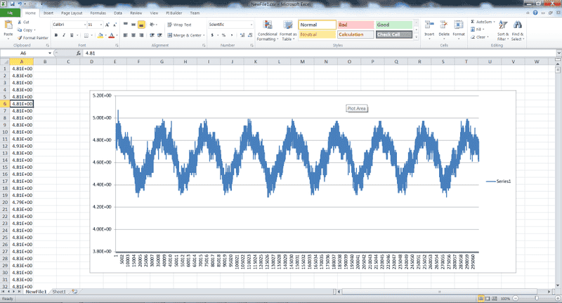

I have input data from a pressure sensor:https://physicsforums-bernhardtmediall.netdna-ssl.com/data/attachments/93/93464-7e84f120a9323e7d16b7dfa59c069739.jpg
We run this into an FFT and found that the max point is at
3.3378Hz. So we did a Digital band pass Filter for 3.3Hz - 3.6Hz.

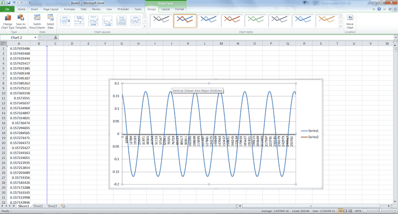

and then we got this :
and this did a fft on that and we got back the same value of 3.3378Hz and that is good.
But the problem is that this wave form has negative numbers and the pressure sensor does not out put negative volts : like you can see in the 1st pic.
We want to know the voltage at 3.3378Hz so we can get the pressure at that hz for troubleshooting a flow loop.
can we did the real voltage back at the hz? are is that not something we can get back ? Why does the waveform in the second pic have negative numbers?
Because a signal with all positive numbers includes a DC (0 hertz) component . You filtered out 0 hertz.
Sorry I don't understand can you please explain more ?
Instead of a band pass, use a low pass filter that allows anything below 5 hertz, the all positive values should reappear.

Here is a signal like yours ##2+\cos{({3.3378*2\pi t})}##
It can be written in the form ##2\cos{{0} t}+\cos{(3.3378*2\pi t)}##
A FFT of that should produce two values, magnitude 2 at frequency 0 and magnitude 1 at 3.3378 hz.
If you filter out the frequency 0 term you are left with just ##\cos{({3.3378*2\pi t})}## which has plus and minus values.

The band pass filter removed frequencies below 3.3Hz. But the constant bias (or maybe it is an extremely low frequency) is 0 Hz, so it was removed. By switching to a low pass filter, it passed the 0 Hz constant bias.
If all you need is a low pass filter, do not use a band pass, which is more complicated.
