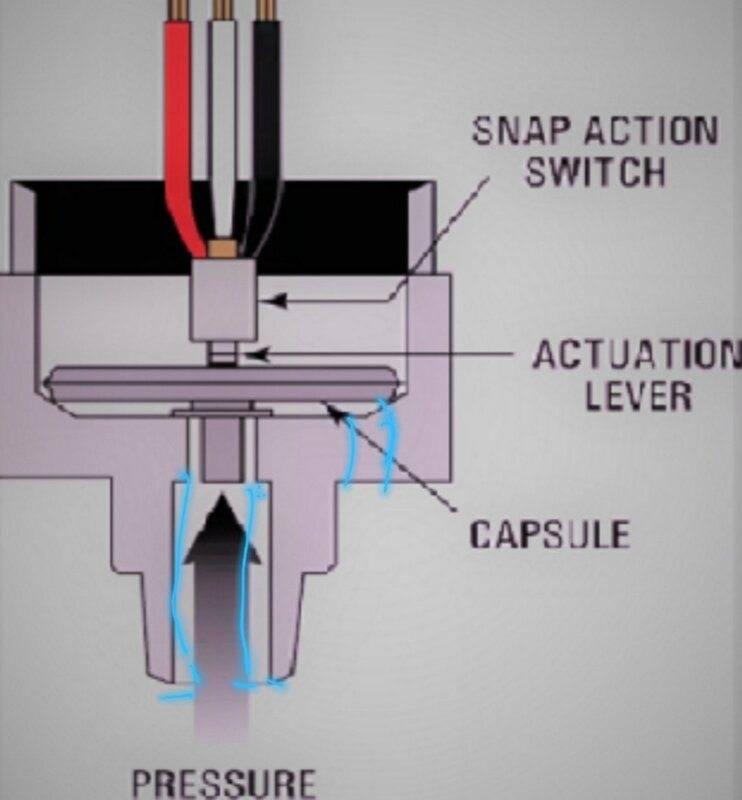

I recently came across a Diaphragm flow switch whose operation many engineers are not familiar with.
First. Supposedly in a normal pressure switch. The pressure will be a maximum when there's no flow, precisely because at zero flow there is no pressure drop anywhere in the system, so the pressure here will be full mains pressure. When the shower-head is on and there's flow, the pressure here will drop.
But in the diaphragm flow switch. It's the opposite. What is in the design in the diaphragm flow switch such that when there is no flow (pressure maximum), pressure won't push the pin. The pin will only extend when there is flow. Let's get back to basic first.
This is the schematic of a pressure switch.
What would happen if the inlet tube is made narrow? Would the pressure still the same given the source has the same pressure? Or would the pressure in the inlet be lesser?
Now supposed you create another hole at the right side of it or an outlet causing a water flow.
What will happen? The piston will move if there is water flow. But if the 2nd hole or outlet is blocked. Will the piston still move from the perhaps poorer pressure?
In an actual device I encountered. The diaphragm no longer move if there is no water flow. Even if the pressure of the source is the same. Somehow it converts pressure right at that junction into velocity via the Bernoulli principle? i haven't seen this explained elsewhere and just want to confirm.

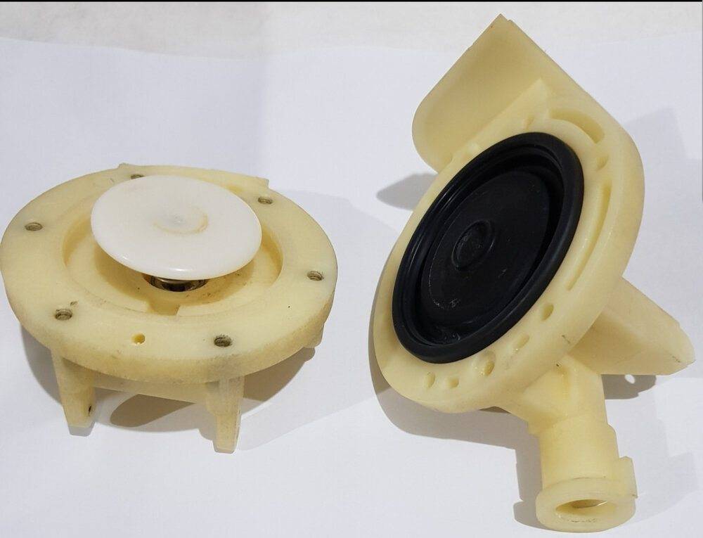

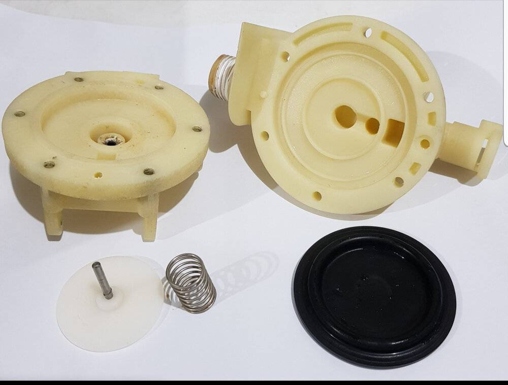

Since I'll no longer use the water heater and bought a new one. I took it apart. Here is inside the white thing.
more details

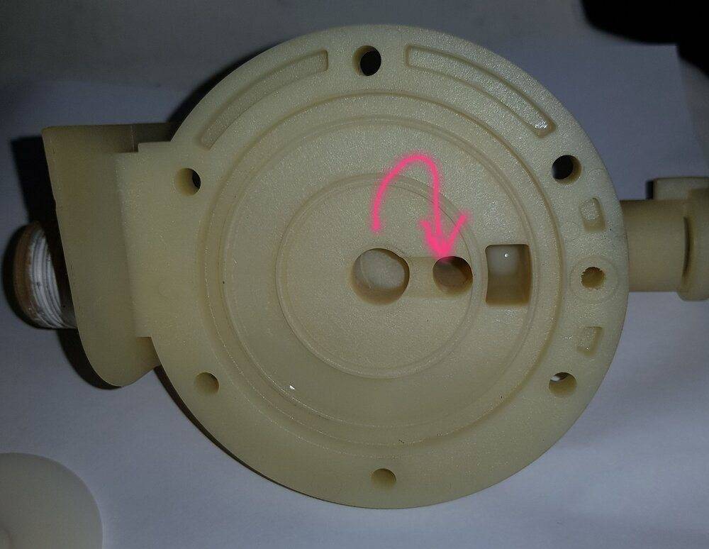

Pink label shows the water flow path inside.

Diaphragm can be designed either sensitive to velocity of the water flow or static pressure. But here is what is confusing. Bernoulli principle can convert pressure to velocity based of laws of conservation of energy. But the source or main pressure is the same. So does it make sense for some diaphragm to respond to flow velocity only and not pressure? What another principle i missed that can make the actual device only move the diaphragm with water flow and not with pressure? (both from same source and same original source pressure)
Well i think the key to understanding it is via fluid mechanics esp. Hydraulics and Bernoulli principle. Imagine a very big diaphragm in the left. Since only small area touch it. Force is small. And if there is a flow. Velocity is large while pressure is small. So i guess velocity from flow can push the diaphragm that the pressure can't.

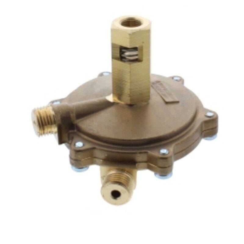

Besides it. Checking the whole world wide web. There is one another product using the same principle.
https://www.dhsspares.co.uk/product/potterton-10-18676-diaphragm-flow-switch.-1120050
"Product Information: This part is located around the flow switch section. The flow switch acts as a safety mechanism. It is a switch with an in-built sensor that sits in the pipework for both the domestic hot water and heating systems. When the pump is powered up, the flow switches senses this movement and feeds the information back to the electronic control, allowing the ignition sequence to progress. The flow switches purpose is to make sure that the burner cannot switch on if the system is dry or low on water."
I don't know why no other products use this and many engineers not familar with it. If you have idea. Let me know.

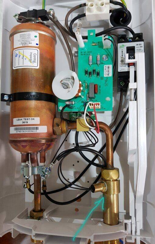

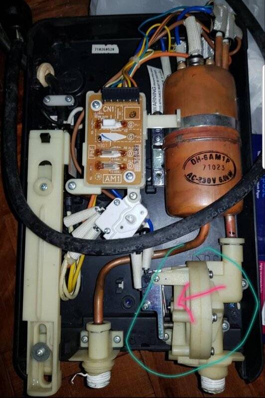

Just to share. This is my new tankless water heater and note the very small flow switch shown in green arrow at bottom. This is the normal elsewhere compared to the big white one in my broken unit. I guess its vintage so kept it for collection.
