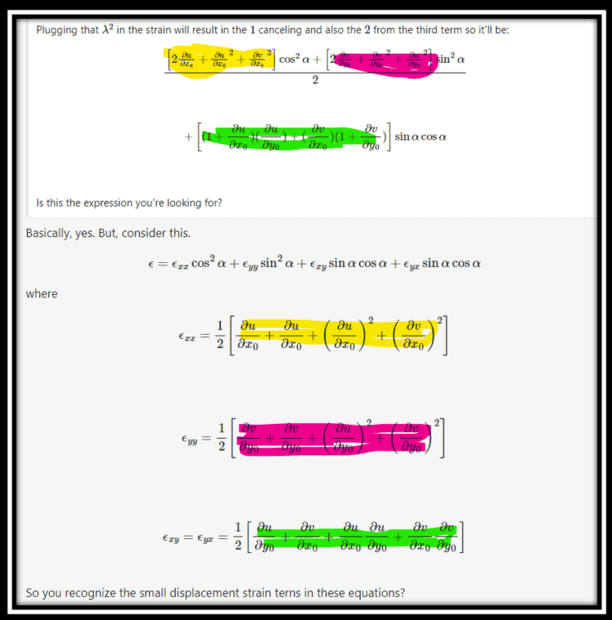

Let $$\frac{dx_0}{\sqrt{(dx_0)^2+(dy_0)^2}}=\frac{dx_0}{ds_0}=\cos{\alpha}$$and $$\frac{dy_0}{\sqrt{(dx_0)^2+(dy_0)^2}}=\frac{dy_0}{ds_0}=\sin{\alpha}$$such that ##\alpha## defines the direction of the arbitrary differential position vector between the two neighboring material points in the undeformed configuration. Then show that the stretching between the material points can be expressed in the form $$\lambda^2=(\frac{ds}{ds_0})^2=(\lambda_x)^2\cos^2{\alpha}+(\lambda_y)^2\sin^2{\alpha}+4\epsilon_{xy}\sin{\alpha}\cos{\alpha}$$From the previous development, what are the expressions for ##\lambda^2_x##, ## \lambda^2_y##, and ##\epsilon_{xy}##?
  • #45
Let me first add the first two equations to the drawing I made before to make sure I'm still following you.
Is this correct?
  • #46
Is this correct?
yes

$$\left \| d\vec{s} \right \|^2 =dx^2+dy^2=(\frac{\partial x}{\partial x_0}^2+\frac{\partial y}{\partial x_0}^2)dx_0^2+(\frac{\partial x}{\partial y_0}^2+\frac{\partial y}{\partial y_0}^2)dy_0^2$$$$+2(\frac{\partial x}{\partial x_0}\frac{\partial x}{\partial y_0}+\frac{\partial y}{\partial x_0}\frac{\partial y}{\partial y_0})dx_0dy_0$$
Dividing this equation by ##(ds_0)^2=(dx_0)^2+(dy_0)^2## gives $$\frac{(ds)^2}{(ds_0)^2}=\left[\left(\frac{\partial x}{\partial x_0}\right)^2+\left(\frac{\partial y}{\partial x_0}\right)^2\right]\cos^2{\alpha}+\left[\left(\frac{\partial x}{\partial y_0}\right)^2+\left(\frac{\partial y}{\partial y_0}\right)^2\right]\sin^2{\alpha}$$$$+2\left[\frac{\partial x}{\partial x_0}\frac{\partial x}{\partial y_0}+\frac{\partial y}{\partial x_0}\frac{\partial y}{\partial y_0}\right]\sin{\alpha}\cos{\alpha}$$
OK so far?
  • #49
OK so far?
Just to be sure.
FROM
AND
$$\left \| d\vec{s_0} \right \|^2 =dx_0^2+dy_0^2$$
If I simply combine both doing
$$\lambda^2=\frac{\left \| d\vec{s} \right \|^2}{\left \| d\vec{s_0} \right \|^2}$$
In the end, it reduces to
$$\lambda^2=\frac{(ds)^2}{(ds_0)^2}=\left[\left(\frac{\partial x}{\partial x_0}\right)^2+\left(\frac{\partial y}{\partial x_0}\right)^2\right]\cos^2{\alpha}+\left[\left(\frac{\partial x}{\partial y_0}\right)^2+\left(\frac{\partial y}{\partial y_0}\right)^2\right]\sin^2{\alpha}$$
With
Is that how it is? It's a hard blow to realize I missed it and I just needed to keep pressing to reduce the expression algebraically although even after looking at the final expression I can't really see how it simplified all the way down to the final expression you showed.
I was focusing on the displacement field because it's the last part we focused on so I didn't think of using the previous expressions. I actually think I could have gotten to a somewhat equivalent point using the expression of the displacement field and I just got lost in the swarm of letters I was trying to deal with.

Basically, yes. But, consider this. $$\epsilon=\epsilon_{xx}\cos^2{\alpha}+\epsilon_{yy}\sin^2{\alpha}+\epsilon_{xy}\sin{\alpha}\cos{\alpha}+\epsilon_{yx}\sin{\alpha}\cos{\alpha}$$where $$\epsilon_{xx}=\frac{1}{2}\left[\frac{\partial u}{\partial x_0}+\frac{\partial u}{\partial x_0}+\left(\frac{\partial u}{\partial x_0}\right)^2+\left(\frac{\partial v}{\partial x_0}\right)^2\right]$$
$$\epsilon_{yy}=\frac{1}{2}\left[\frac{\partial v}{\partial y_0}+\frac{\partial v}{\partial y_0}+\left(\frac{\partial u}{\partial y_0}\right)^2+\left(\frac{\partial v}{\partial y_0}\right)^2\right]$$
$$\epsilon_{xy}=\epsilon_{yx}=\frac{1}{2}\left[\frac{\partial u}{\partial y_0}+\frac{\partial v}{\partial x_0}+\frac{\partial u}{\partial x_0}\frac{\partial u}{\partial y_0}+\frac{\partial v}{\partial x_0}\frac{\partial v}{\partial y_0} \right]$$
So you recognize the small displacement strain terns in these equations?
  • #67

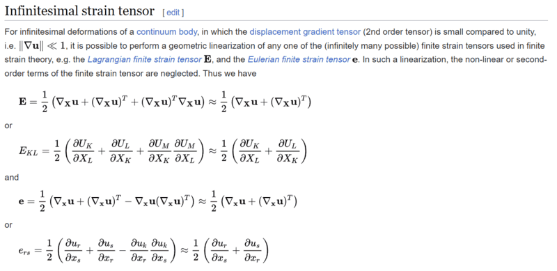

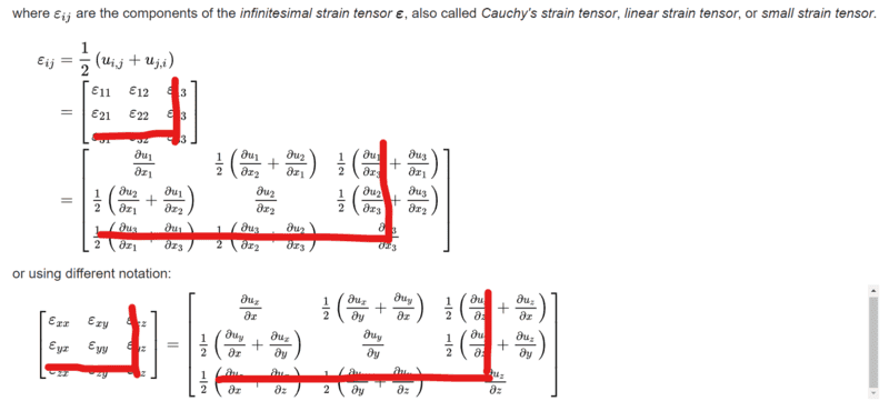

Are you referring to how 2nd order terms are typically ignored if they're very small compared with 1st order terms?
From Wiki
https://en.wikipedia.org/wiki/Infinitesimal_strain_theory
After doing the math and ignoring what's going on with the 3rd dimension so that it looks as the simplification developed in this thread, the infinitesimal strain tensor is as shown.
Is this what you meant?

View attachment 334075Is this what you meant?
Yes, these are the small displacement (linear) terms in the strains. If you had also included the z direction, those strains would also be also be properly accounted for too by this methodology. By the methodology, I mean using ##\frac{(\lambda^2-1)}{2}## as a vehicle to elucidate the strains in terms of the displacements.
These equations could also be used (the full expressions for the strains including the non-linear terms) if the displacements are large but the strains are small (e.g., for a very stiff material). Under such circumstances, the 3D Hooke's law equations could still be used. However, if the displacements and the strains are also large, Hooke's law could not be used, since it is only valid for small strains. That is when wee enter the realm of non-linear elasticity and more complex material behavior.
Likes Juanda
